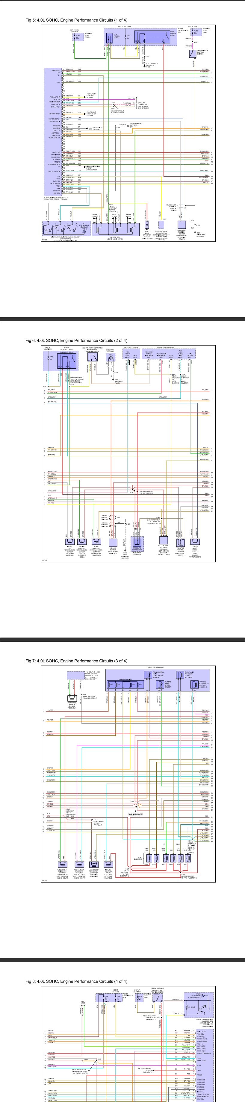

with removing you hvac box and considering that the spark plug wires for the passenger side of the vehicle cross over the connector that goes to the transmission harness, it sounds like you are on the right track. id wait for the sun to go down and get a mirror or something and see if your spark plug wire might be jumping to that harness. Also make sure that your radio capacitor is good and in place as it will act as a filter for the radio and absorb any strange voltage spikes. The capacitor is on the bottom center of page 1 of this wiring diagram. on the coil it should be a tiny white brick with a metal tab bolted onto the coils

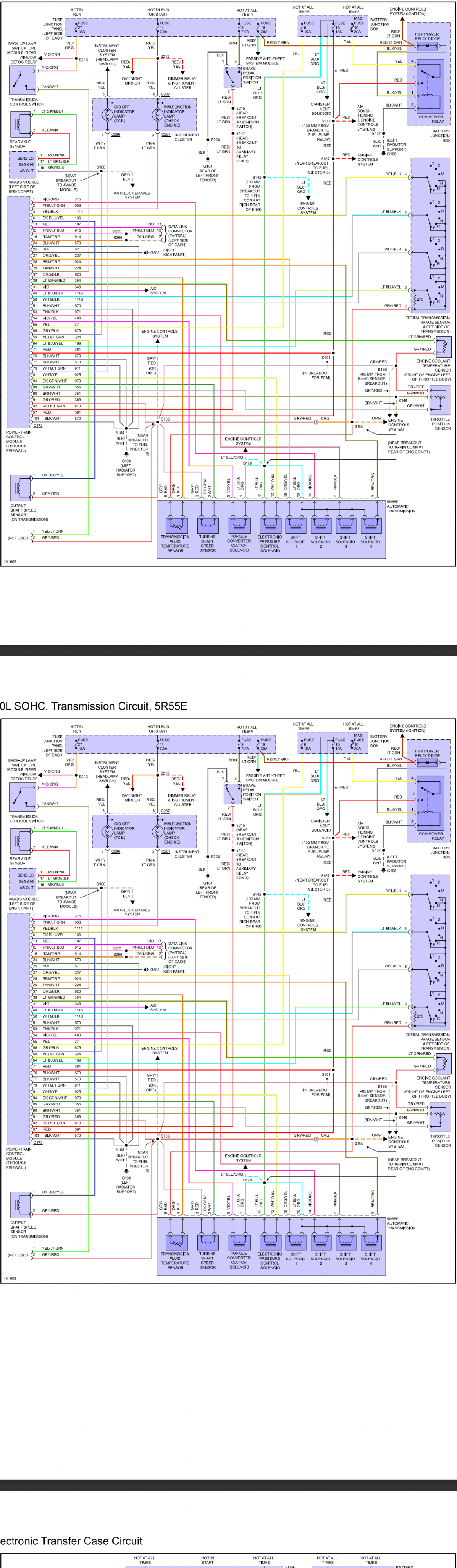

As a side effect of my weaponized autism, I spent a few hours staring at schematics. I wanted to know WHY the RAP was making the light flicker. It didn't make sense. I noticed something interesting. It seems that the RAP is fed brake pedal position info from the BPP switch, which makes sense (auto lock doors when brake pedal released).
This brake pedal position input also feeds the GEM.
I started looking at the GEM schematic more closely. There are a lot of interesting circuits that go through the GEM, to include sensors like the throttle position sensor, which use circuit 359 as a signal return to the PCM, which is shared with the OSS.
The GEM also shares a power feed with the radio, which has been picking up a lot of system noise on the AM bands.
What if the GEM is going south, and wreaking havoc throughout the truck?

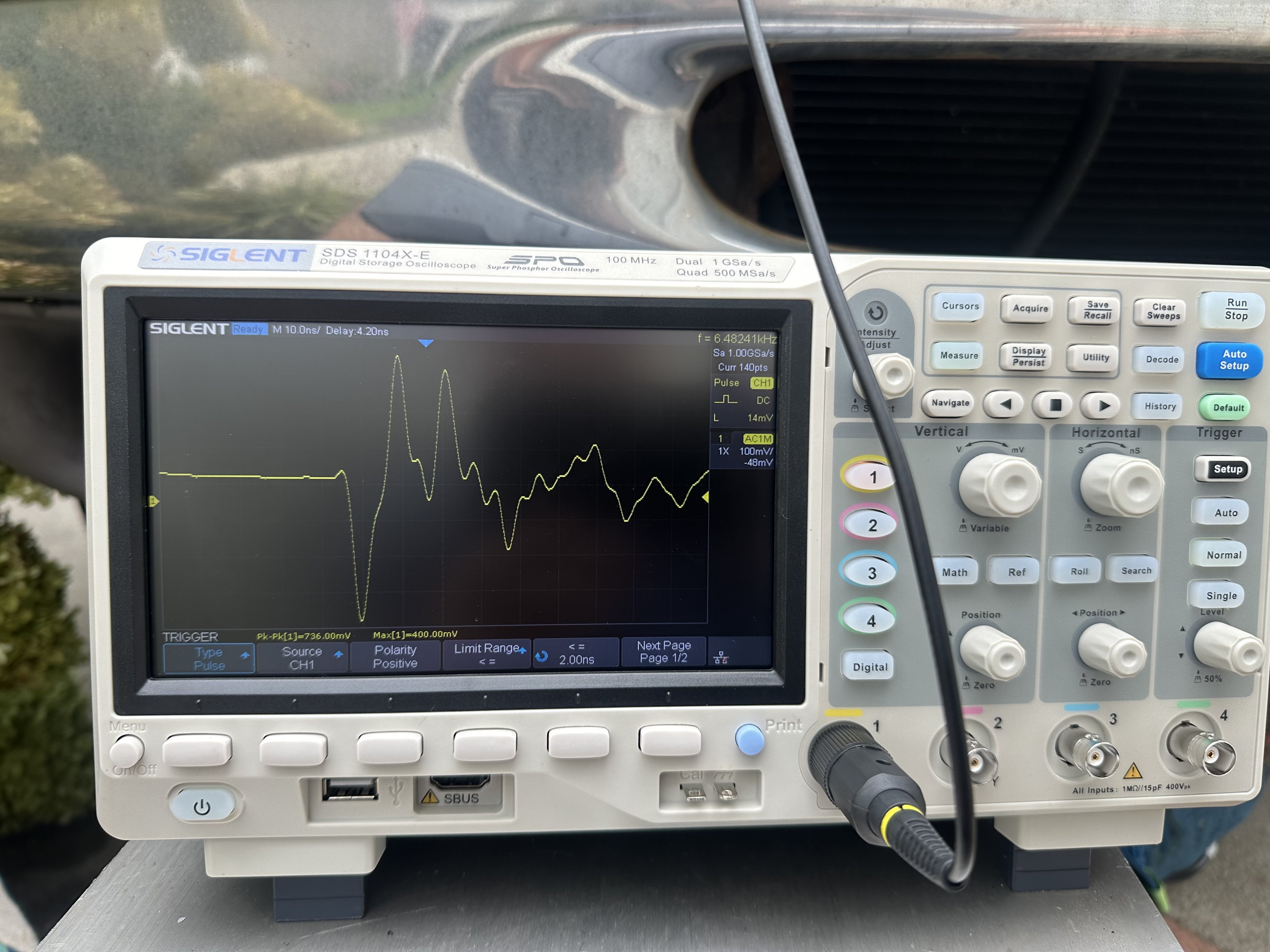

I have a spare Bosch alternator. I don’t want to throw it in yet. Trying to avoid the parts cannon. I’ll wait for my oscilloscope to arrive and see if I can figure out what is going on in this truck—the Forscan data just isn’t enough, I need actual waveform samples.
