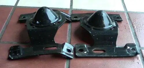

Painting was postponed for a little while. Bumped into a Nissan and my front bumper bent. So, i took some pics of the brackets. You can see the difference easily.

Ouch. I did the same thing when I first got my Explorer, except I hit someone else's car :D... I just took off the bumper and brackets like you did and got out the BFH (Big F*ckin' Hammer for those that don't know) and knocked the crap out of the brackets until they were straight. Put it all back together and you couldn't even tell anything happened. Have fun...

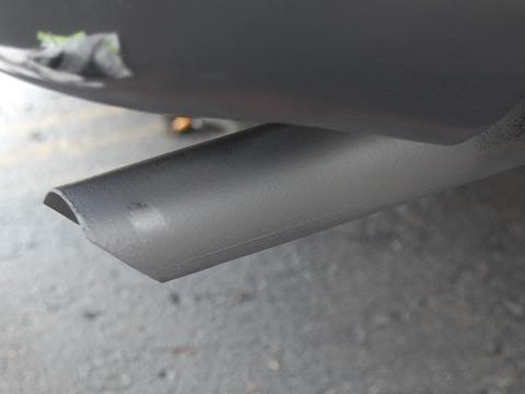

Thought it would be neat to spray my tail pipe with truck bed liner

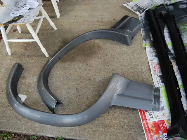

Rear fender flares sanded

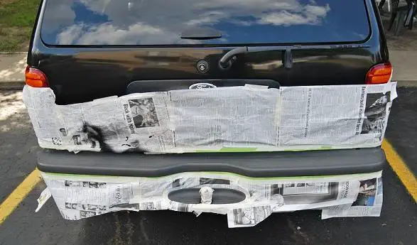

Rear bumper painted

My rear bumper wasn't chrome. It was already painted gray. I wet sanded everything with 400 grit. 2 or 3 coats of Krylon Fusion gloss black. 2 coats of clear coat.
