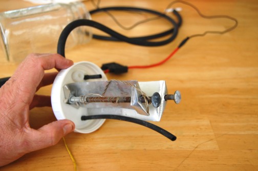

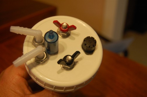

Aldive this is just a suggestion and what I am planning on doing. I an going to hook mine up to the fuel shutoff switch, just in the event of an accident it would stop the production of HHO gas. That seems like a good safety factor to me.

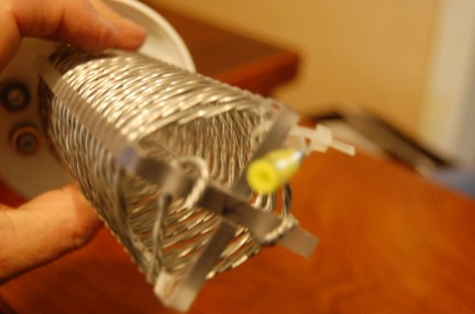

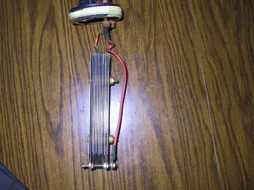

Here is my second one ....

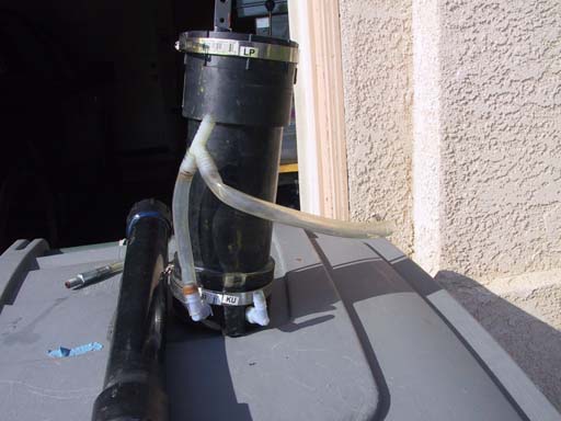

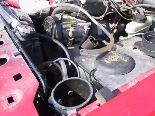

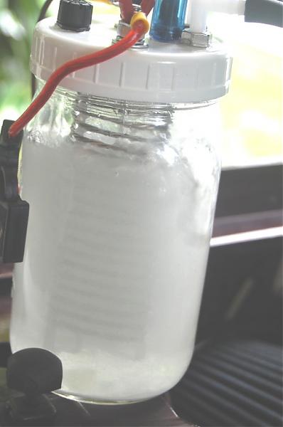

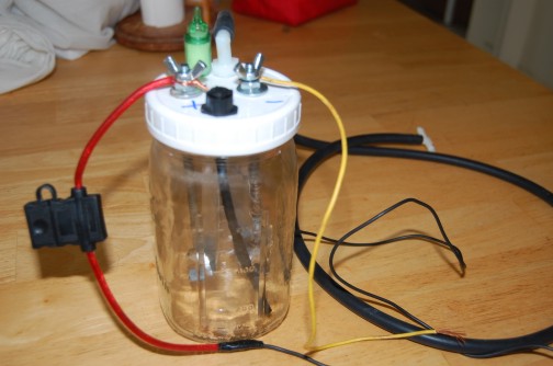

Ok Al

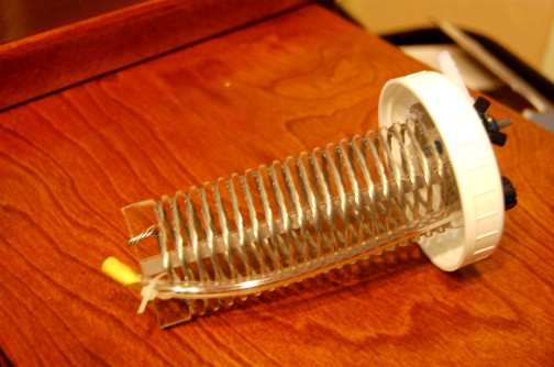

Here are some pixs of my Generator. Cell/housing and 2nd bubbler out of the truck. The 1st bubbler/reservoir are shown in the truck. I'll get more pixs when I reinstall the generator. The cell is a 13 plate setup n-nnnn+nnnn-n the plates are 6"x 2.5". I have it wired through the key with a kill switch on the dash. At this time the generator draws just under 20 amps and stabilizes at about 160 degrees

Well at this point I get no increase in mileage but by the seat of the pants dyno it feel a little peppier. I have no way (yet) of checking the F/A and have not fooled the computer. The cell puts out about 1 liter per minuet.
White vinegar and one quarter teaspoon of baking soda, in one haft gallon of distilled water.
I still get the pond scum though.
ohhh sorry 2 cups of vinegar
