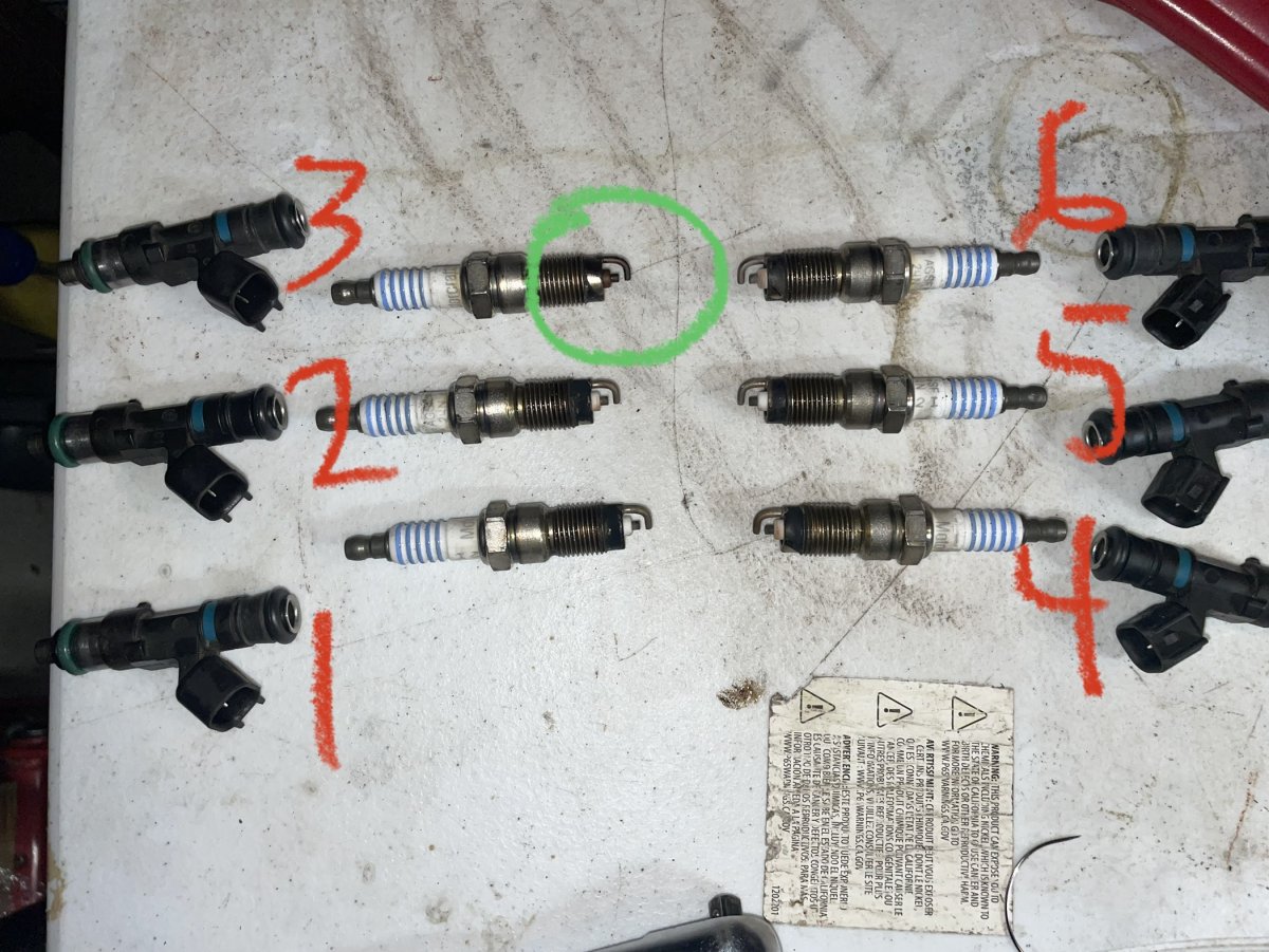

I pull things apart to get down to what I suspected was wiring since I noticed the wires were brittle around the connectors, and at the throttlebody, and also the EGR connector. Also, I believe I got a misfire code for cylinder 3 at some point, but after erasing codes that one didn’t pop back up.
I then drove it to work. On the way home, it pulled the EGR code P0401, P0303 cylinder 3 misfire and P0171 again but not all the throttle body codes. The EGR seemed to have issues before and the top piece with electronics seemed to spin freely unlike the replacement part. The EGR code was gone and didn’t come back but now theirs a hesitation and what feels like a misfire.
I pulled to end apart again and tested connectors. It’s seemed like there was an unusual amount of resistance in the connectors. I suspected wiring was cross connecting down the line since I found other brittle points. I pulled wiring apart in main harness. There was so much brittle wiring at almost every connector and every point where the wire had to bend on the top end.
I sealed it all over 2 days with liquid electrical tape. Resealed with new tubing and heat resistant tape. I reconnected everything. The rough idle is still there. I also did a test without the cylinder 3 spark plug wire plugged in. There is definitely a spark but when I remove it I don’t see any difference versus reconnecting it. But there’s no misfire code.
Now the only codes are still P0171 - Lean and now P0340 cam position sensor. I went ahead and replaced the sensor. But still the code doesn’t go away.
