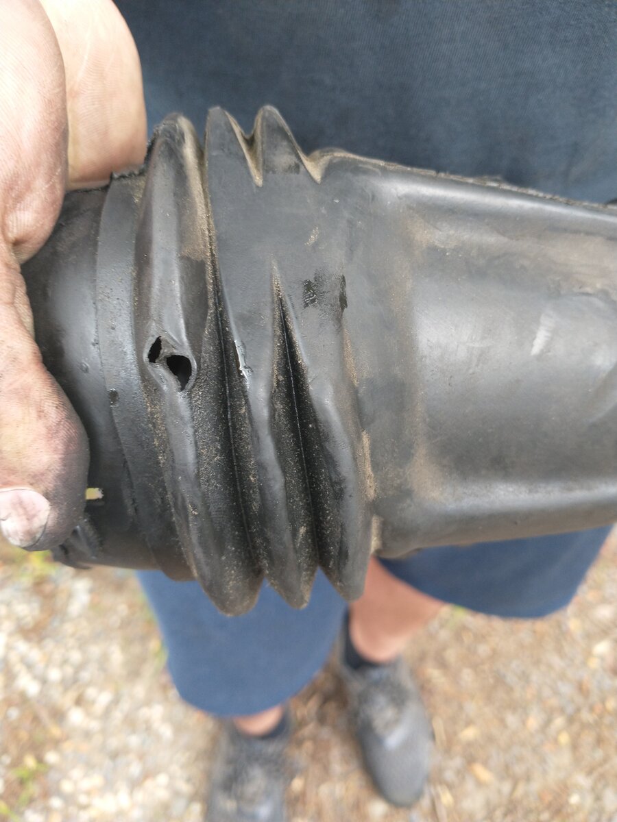

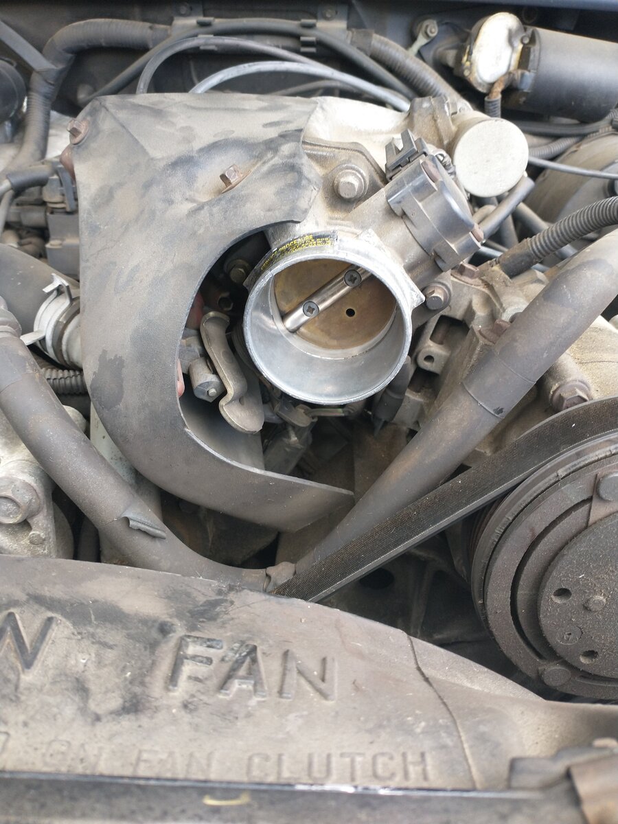

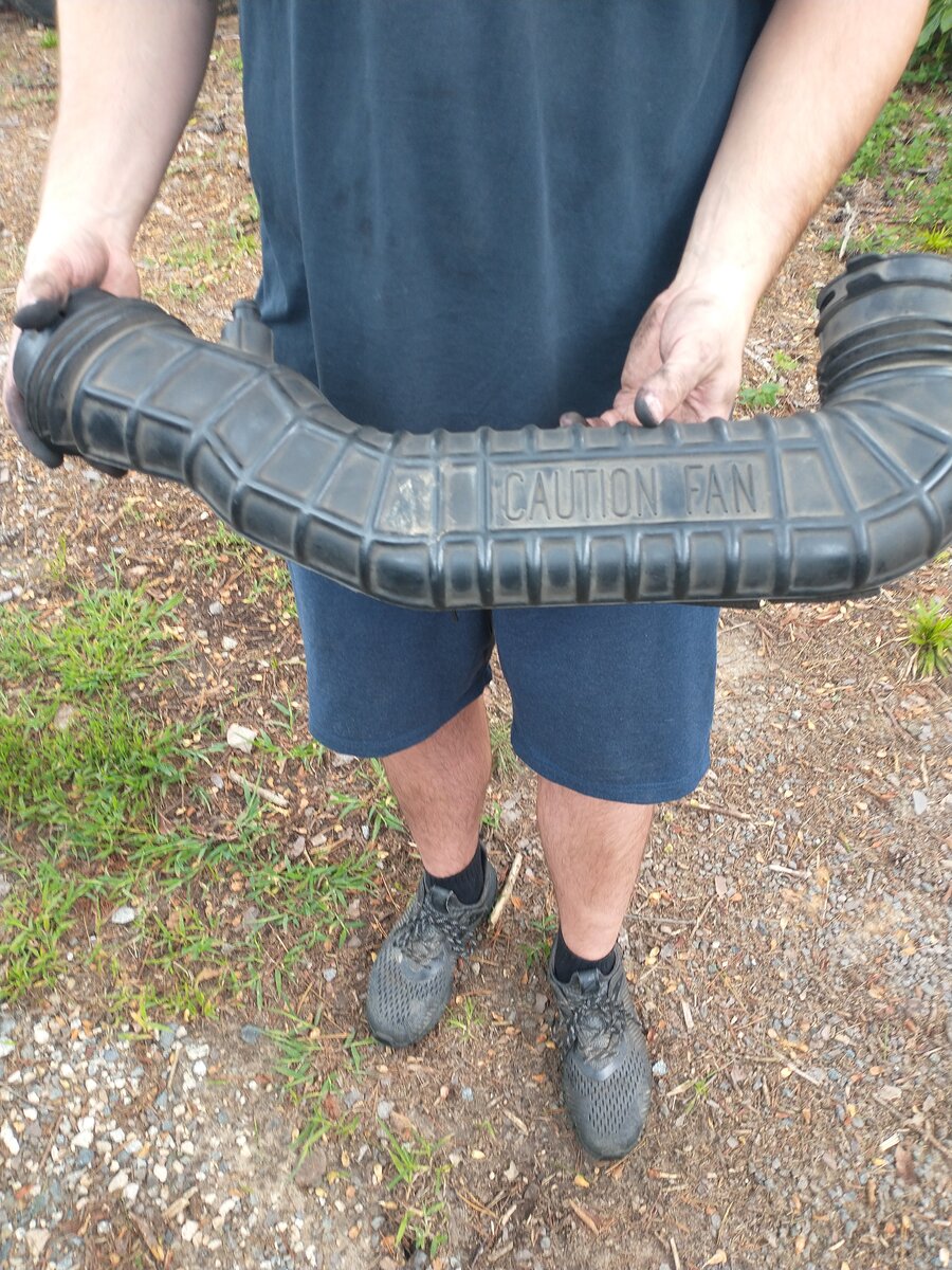

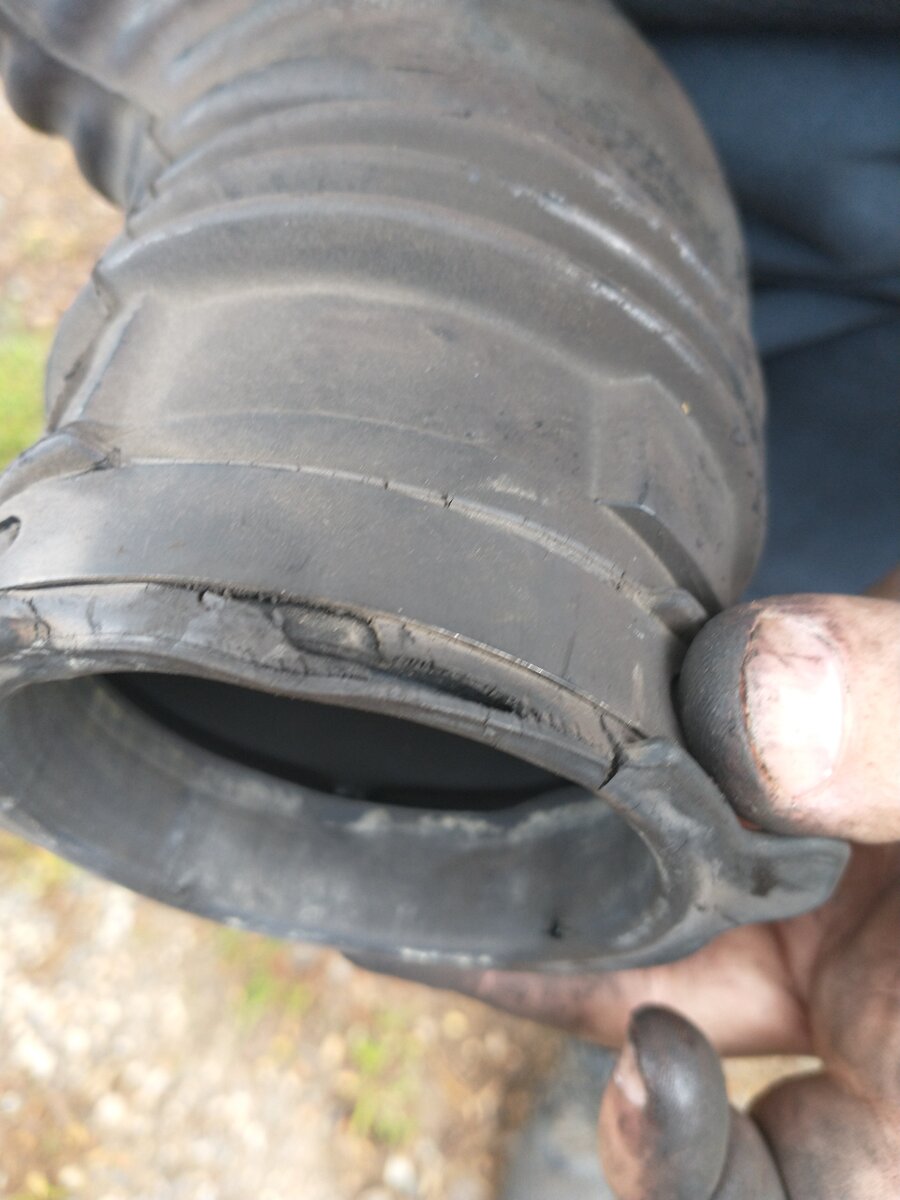

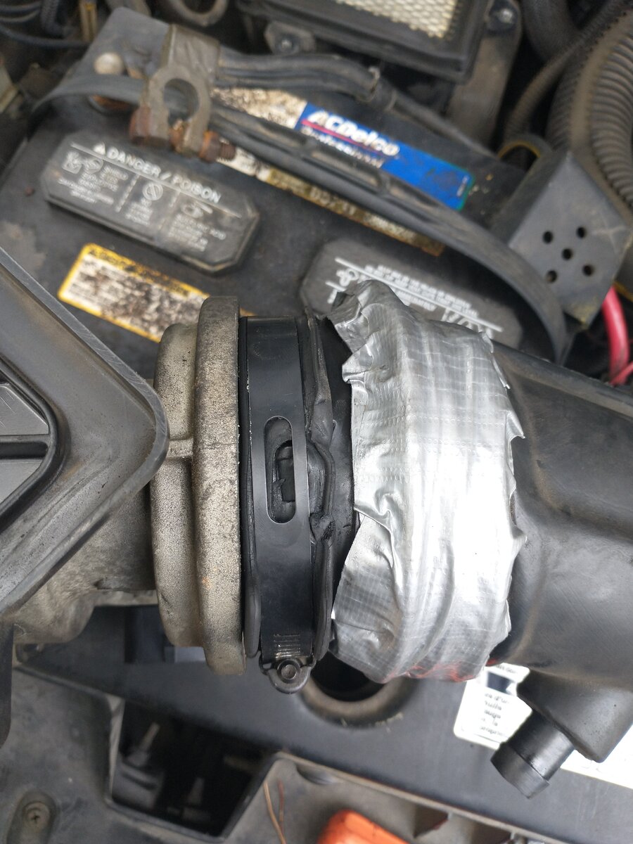

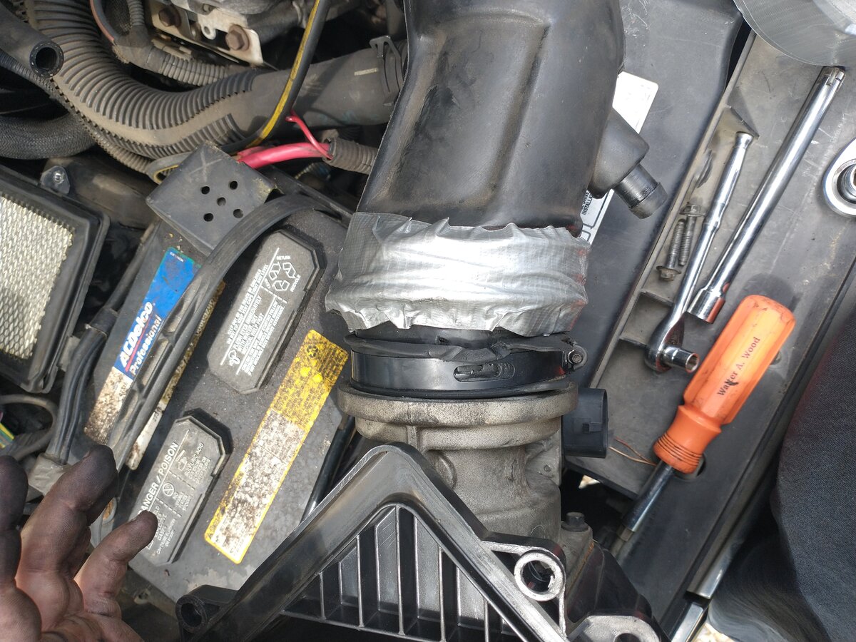

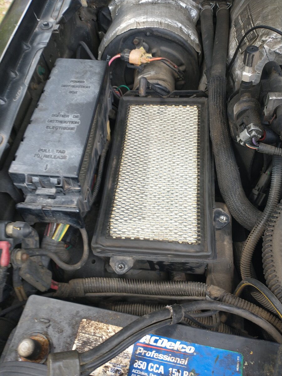

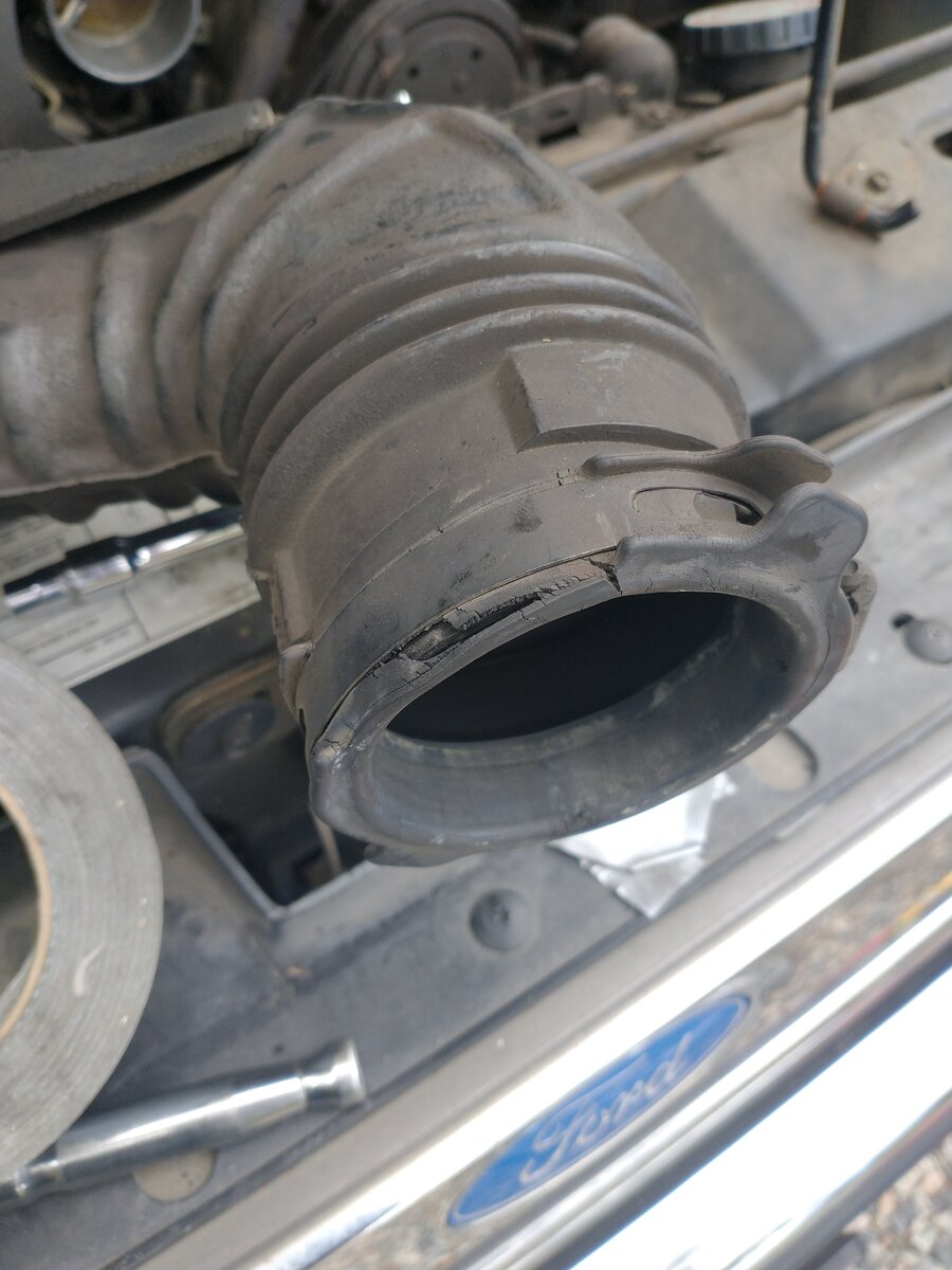

So I was having some issues with my 93 explorer 4x4.no egr.felt like it was stumbling or dragging.loss of power.honestly I thought the exhaust was choked up or fuel pump was going.i started with the air filter and throttle body.air filter was dirty as hell but looked ok will replace.cleaned the throttle body and removed intake pipe.to inspect maf.the grommet that connects pipe to maf box looked like it had been connected wrong and been that way for 20 years.the rubber was bent out of shape.while inspecting I noticed a hole in the pipe where it flexes.temporary fix with duct tape.also when connecting back to maf.the pipe is so crudely built that it did not fit properly.this thing has probably been sucking air behind the maf for 30 years.thus this was my problem.un registered air was getting sucked in through holes and leaks.ill probably just end up replacing the whole assembly with an eBay cold air kit.or some sort of home built snorkel.runs 100% better now and finally getting all those 160 horses
