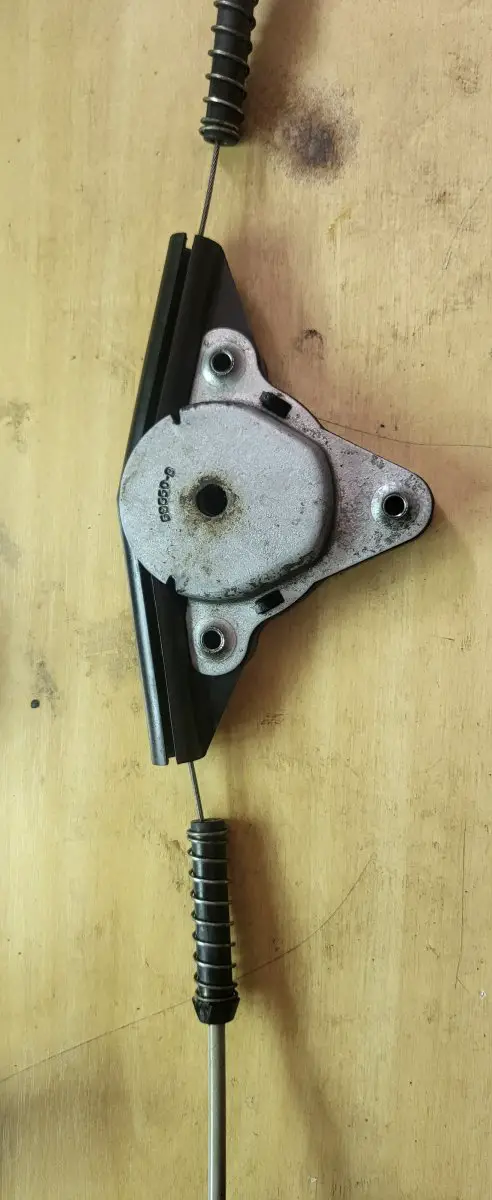

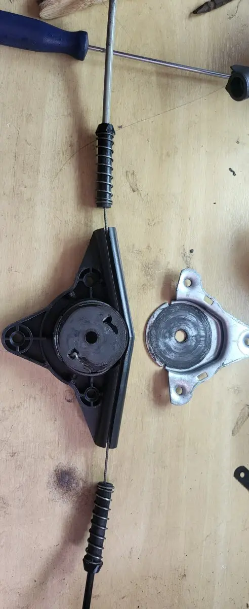

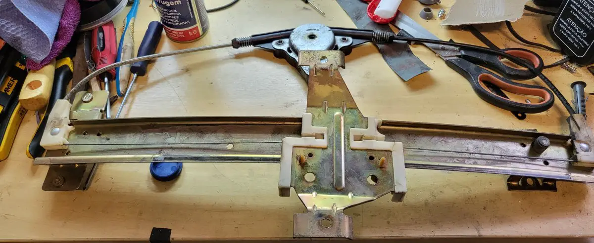

I have disassembled entire power window because it was barely lifting the glass. So, I have disassembled in bench, cleaned it all. The motor is good, maintance done in it.
When the structure was disassembled, the glass carrier was sliding great after lubrication. The cables too, when disconnected from structure, it slides great , the reel rolls very smooth.
But when the cable is installed into the structure, it became to be heavy to slide by itself. And I can´t get it better. Used Lithium grease, don´t get better. Cleaned and used cooper grease, no success.
So, the problem is with the cables and reel. any suggestions ? Did you guys have been into this?

I have greased all cables and move it a lot into sleeves, to get lubricated. I don´t think the WD-40 will do better, but be sure I´ll test it!
About roller bearing in the reel... it doesn´t have a bearing... just the plastic reel, the casing where this reel sits and a metalic cap... I tried to search photos on internet, to see this reel disassembled, but no success into find one which have it disassembled to look.

Yep, I have disassembled, and cleaning all that old grease, and the plastic bits... cleaned the points for rotor, all good, assembled it back, no rust at base or the other edge, top of that axle. When running, the motor has great torque... But you are right, I have seen in other door, one great diference before and after the cleaning and lubrication.
when this structure is all disassembled, the parts rolls so easy, so light.. the cable part looks like grinding when assembled... the cable itself is perfect.
The glass at the door easily goes up and down by hand. I have assembled the structure, and the whole thing works heavy without the motor. Without the cable, but the structure still attached, works great by hand.
But with sooo many lubrication , the glass runs up and down, but so slow.. I made some experience: get the motor from one window which runs OK, and put in this rear window. And the result was.. works slow too. So, isn´t the engine.
I´ll keep searching for a solution, and all comments are welcome! And thank you for replying
