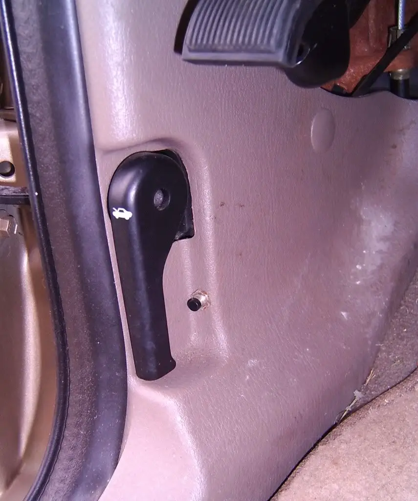

Aldive, do you know if this is our reset button? It's located above the driver's kick panel in my 03.
As far as I know and I have never heard of one, there is no reset button ( at least on my '99 ).
I'm going to try it later in the morning... Ive never seen that thing that I can recall.
Umm, that would be the parking brake light switch... I can tell by the light green w/red wire going to it. The switch grounds the circuit when you depress the parking brake pedal, illuminating the light on the dash.

I will take a photo of the button and post it later today.

Well, glad I didn't sit there pressing the button. This is a trip... I gotta see this button!:cool:

We recently traded my gf's 95 for an 02 explorer it does have a factory alarm system, the override button is almost in the same location as the one in the pic above, system has the red flashing led, also an impact sensor, module on hers is below the center console and you can turn off the auto arm option by opening the module and opening or closing some switches inside, ford PN F3AZ-19A361-C, owners manual says "system 4", per owners manual the hood pin is optional and could easily be hooked up (haven't tried this yet). I tried arming the system and then starting the truck and it did set the alarm off, so I had to push the override switch and that was it.

Or if you're handy, you should be able to get under the driver's side dash and figure out what was there from factory and what was added and remove it yourself. With a switch like that it's definitely not from factory.
