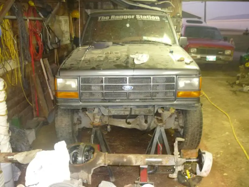

I'm not ready to start on the D44 stuff yet. Need to get my Bronco running and out of my shop. My buddies rnager has been sitting outside my shop all winter. This is the innitial fit up to see which way we were going to go. This is Stock D44 beams in the RBV pivots. There should be a TTB build section.
From what I remember RJ just tacked the D35 stuff together then took it to a buddies place to get it fully welded.
