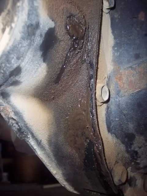

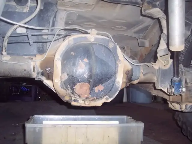

looks like the navajo's going on vacation for a while. i need a new rear end. the diff is breaking away from the axle tubes :( if i take it out again i'll probably spin the whole diff. so i don't plan to have this guy out on any trips soon. money and school are not liking me right now.
so, does anyone have an 8.8 for sale? or maybe a 9"?
Have you welded the tubes to the center section ?

Just weld it up dude. That is a common 8.8 issue. Has it spun yet? You should be able to tell by looking at the plugs. My brother spun on in his Jeep. We got a cheepy housing, welded the tubes and made a big old over the axle truss. Then wheeled the crap out of it! No need to have it welded. Use a stick welder turned way up and go slow. We went too fast and His looked like a taco when we got done!! Kinda smiling! He has a Full Float kit though and it didn't leak so he ran it. I guess you are suppossed to weld an inch and let it cool to the touch. They say to do it whil you are working on something else and just be patient. Have you ever looked at Tnt customs? They have a sick 8.8 truss. Developed for the jeepers, but hey we can benefit from that!
Here is thier website. You would have to call them and ask them about it. They list a truss for $150. I know I saw an 8.8 one they were developing though.
http://www.tntcustoms.com/treks_home.asp
thanks Kirby! i just don't want to warp the axle/housing
oops. I just say that because my mig is a worthless 110 unit. I use my 220 buzz box for anything that needs any amount of strength/ penetration. A nice 220 mig would do the job too- better! (I wish I had one!)
talked to currie a few days ago. welding it won't help :(
he said there needs to be a little bit of play in the tubes, so if i weld the center to the tubes the stress will have to go somewhere and probably crack the diff housing. he said the only thing you can do with a 8.8 is truss it top and bottum.
looks like its time to renew my eliteness
plenty of 8.8 people weld the center section to keep the tubes from spinning, works great for most! Currie often thinks overkill, I mean you cant run a 35 on a dana 35 ttb according to the charts either.....but we all do it!
I think Rick welded his center section because he has spun a diff.
Not sure tho but welding it would be what i would do also
x2- take currie's opinion with a grain of salt. They would love to sell you a custom axle replacement and it is in thier best interest to tell you yours can't be fixed and you need to buy another one. (preferably one of thiers!)
I welded mine, too. I read an article in petersons where tnt customs in cheyenne built an 8.8 for a ZJ and welded the tubes, then they insulated it and let it cool slowly because the cast center cools at a different rate then the tubes causing the welds to crack as it cools. I just watched mine and did another pass if it cracked when it cooled. Ricks spun a housing and he had fst straighten it and weld the tubes together. There is a writeup about it on here somewhere. I remember reading it.
Weld it up. Whats the worse that can happen it spins again. and you are back to the same point you are right now.
if it was just a spin because of over powering it, i could weld it. like if it was an 8.8 in a mustang and spun. but since its breaking from beating on it to hard, welding will only temperally fix it, until it brakes somewhere else :(
currie loves overkill (in their trucks its probably necessary) but they do know their stuff and even if they are just trying to sell their products to me, they didn't mention they're parts at all and didn't try and sell me anything. they just said if your gonne beat on it, truss it as much as i can.
they also said i would have to take the gears and such out when welding, that true?
