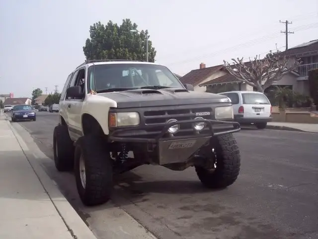

Did you sell your old wheels and 33s? I always did like that combo. Hmm...
havn't sold them yet, but for sure they'll be for sale. but the rims are not sell-able because they're more square than round.

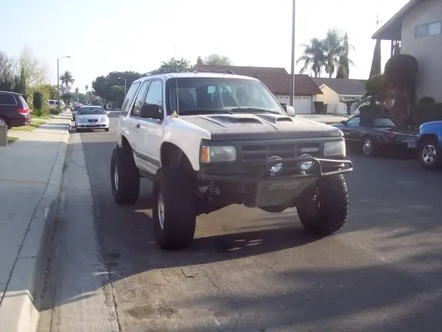

I love it, nice and low just like I would do!
LOW!? this thing looks huge to me now! i've never had that much clearance in the back hahahaha. but i think its perfect :cool:

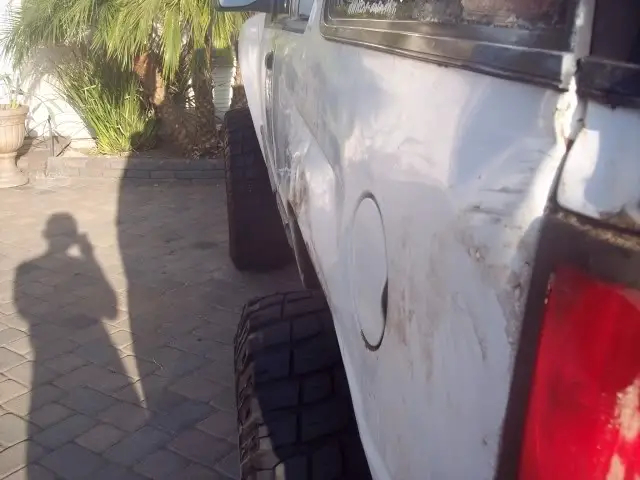

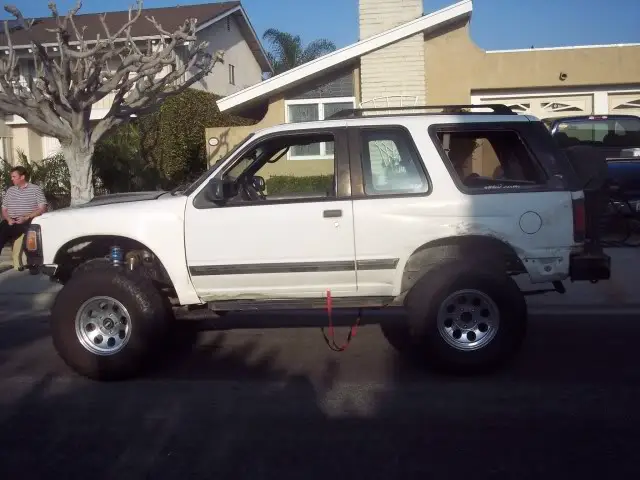

nice, looks great. be really careful haulin ass with the rear that wide and no glass. the tires will smash into the fenders and destroy them.
my bump stops should be low enough stop them from smashing the fenders. and if the do hit the fenders i have a new sawzall :D
but i like it the width front to rear matches up real nice :thumbsup:

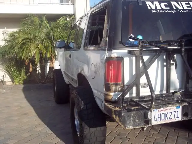

front and rear width just about lined up the same. which is sweet. i did notice that i setup the rear axle off center about an inch to the right. oh well good enough.
yup, still need a rear window, fiberglass and grill are still broken, and the shocks aren't installed yet. in time, in time.

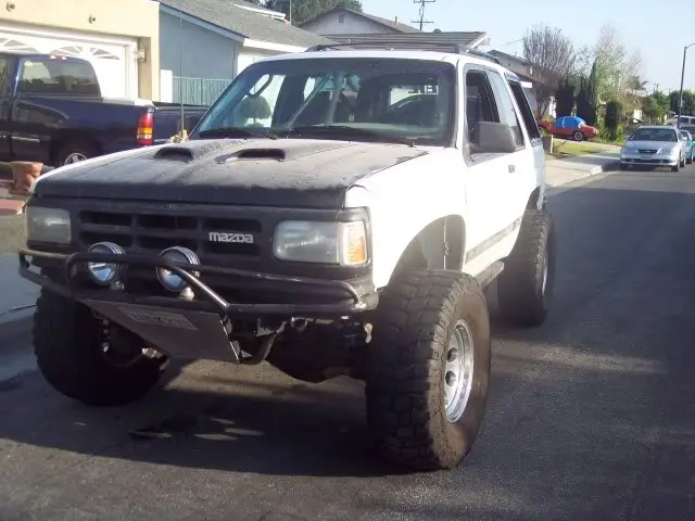

Looks good RJ. Much better with the Navajo front end. Too bla (Drab) with the explorer grill and lights.
That 1" would bug me more than the 3/4" my body is shifted. It bugs me to no end and plan to loosen the mounts to pull it back over to center it. 3/4" isn't much but makes a difference when you look hard enough.
it doesn't bug me :)
something always looks off on the car, like the gangsta lean.
i measured at least three times to make sure i was lining the perches up right, but maybe theres a difference between explorer and f-150 axles, cause i was measuring from the diff to the perch on the explorer axle to line up the the new perches.
i mean come on, im drivin it without a rear window and broken fender and it doesn't dother me. no rear shocks, that does bug
If I am not mistaken there is a slight shift or offset to the right on the Explorer Axles and the drivelines for that matter.
i don't know, they're weird. i remember measuring the stock one and the pumpkin doesn't actually sit in the middle.
That stance looks BAMF RJ ;)
THANKS!!!!!!!
the cool part is it still fits in the garage. with only about 3/4" clearance :D

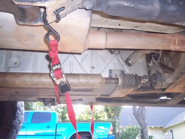

didn't get to far from my house before i ran into the first problem... drive shaft is to short. slipped out on the freeway.

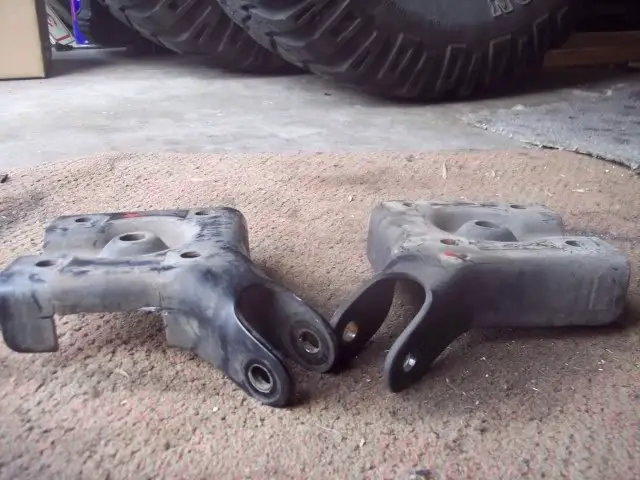

took stock ones and cut it a little. modified stock stuff is my style i guess haha.
bolt it on the top. should work (pic is stock vs custom)

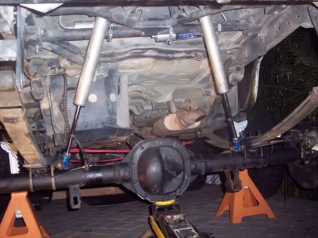

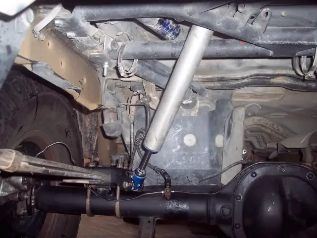

shocks are mounted. i think i'll do a quick cleghorn run next week to see what works and what needs modified. shocks might be to long for the space and they may be lated back to much. we'll see.

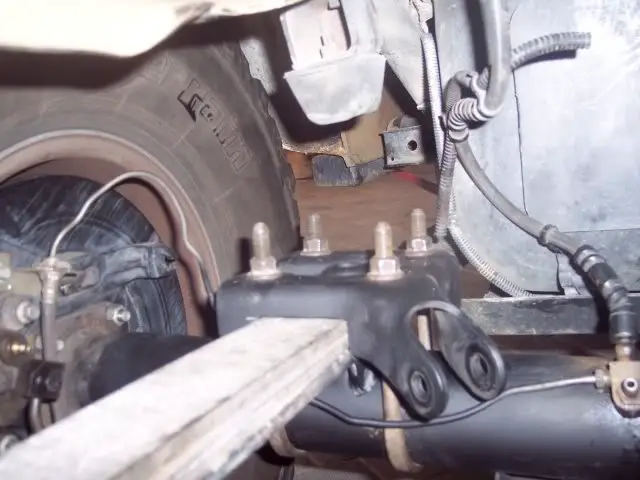

hmm the U bolt plate mounted around the spring like that should be interesting, the leafs like to walk alot during flex and driving, I would be interested to see if they slam into the sides of the u bolt plate notch, could help keep them together but it could cost you some travel
I would be more concerned with the plate bending allowing the u bolts to loosen up. Even my 1/2" thick plates have a bit of a bend in them.
Your lucky your driveshaft didnt take your transmission with it!!! When mine fell out it broke the transmission in half. lol
