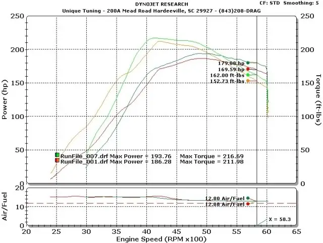

Trans & Rear is good to go...Just been slammed with work, so just been driving it around...Were in the process of having our own port design CNC'd hopefully before years end, so I may be trying a set of them on there along with a nasty N/A cam...Haven't had a chance to make any dyno pulls yet, but hopefully soon...

UPDATE - Still no tuner yet, just dynoing mods. BBK 78mm TB & Plenum made a 10rwhp/10rwt gain at 5800rpms, Air/Fuel still steady.
