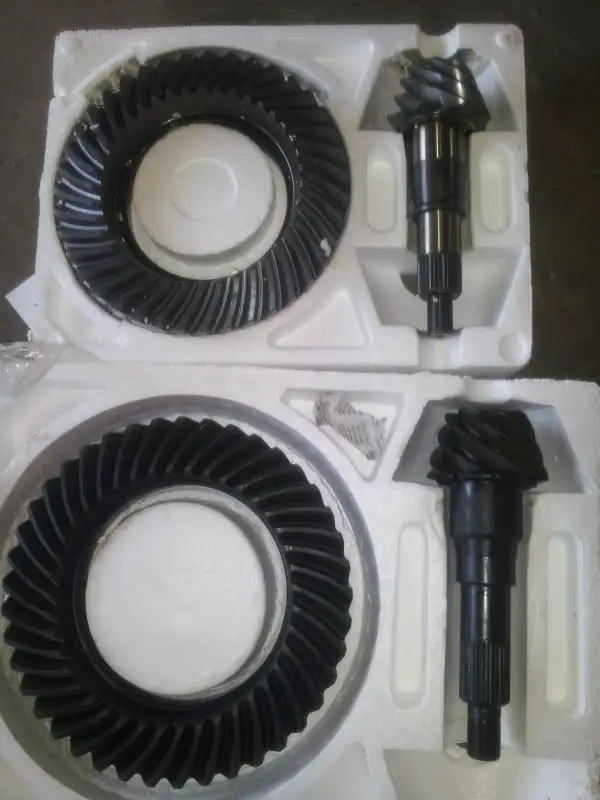

Here is pic of 9.75 5.13 Yukon gears next to set of 8.8 4.88 Yukon gears.
As you can see the 9.75 gears a slightly bigger. LOL From what I have been reading the 9.75 has the same amount of teeth as the 8.8 on the ABS tone ring should make it easy to make the speedo work since my programmer does tire size and gear ratio.

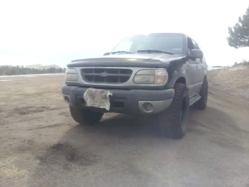

Also I have been working on the new Ranger. I need to get it done. And I picked up 99 Explorer I am doing a lift and 33s on it with 4.88 gears. Already did 1354 swap to it.
Pic before the lift.
