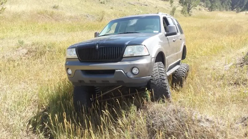

So just bought the wife a new 2012 F150 FX4 Ecoboost she told me I can have the Lincoln Aviator and do whatever I want with it. So I am going to SAS this beast. Already started collecting parts. This time I am going full widths.
Here is pic of the bosses new truck...

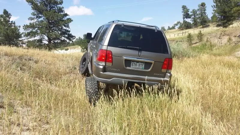

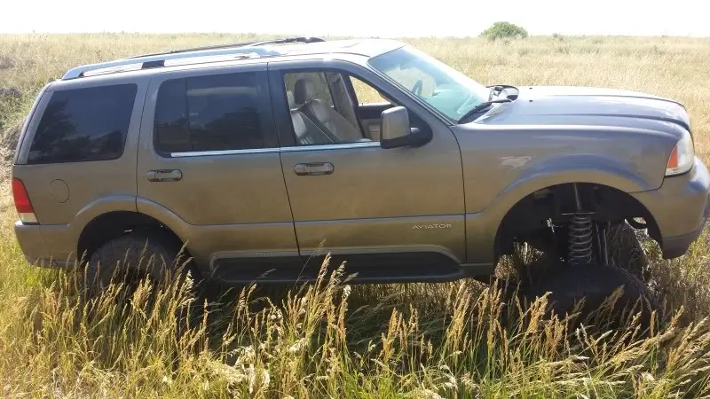

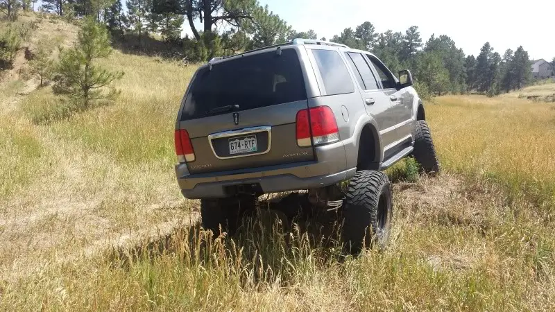

Project Lazyboy 2003 Lincoln Aviator 4.6 DOHC 5 speed auto AWD.
Plans for the truck
3/4 ton Chevy leafs rear.
Ford 9.75 5.13 Detroit
F150 High pinion Dana 44 5.13 electric locker
Custom long arm set up with coilovers
Electric shift BW1356 (should fit since the frame is wider and gas tank is on the pass side).
I should be starting the build in the next couple months. We are getting ready to move so I may not start until mid/late Fall. Stay tuned....:D
Oh and if anyone wants some upgrade parts for there Explorer or Mountaineer the Lincoln used Aluminum front control arms and I think a few other things like bigger brakes all that stuff will be for sale. Also the Aviator has 4.30 gears in it now those axles will be up for grabs when the time comes.

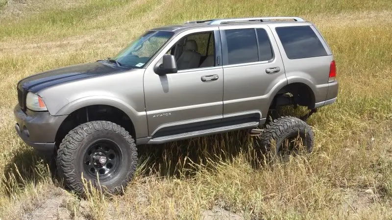

Hey Stang, just wondering - after you cleared out all the IFS/IRS parts, what do you think the minimal lift possible for an SAS would be, while still having descent up travel?
I know that cursed frame hole and accompanying low spot in the rear could still be problematic. I was sort of thinking though that one could cut/grind that area for more clearance, then just reinforce the upper part and over the hole.
I'm quite interested in a x2 SAS, but mostly for additional strength, more availability of parts and to rid myself of 2wd. 37s and 7in of lift on a Sport Trac would be a sight, but also a massive poser-mobile given my realistic offroad needs.
Thanks and good luck finding a t-case.
You might be able to do get it down to 6-8 inch range on lift. Yeah still looking for a case. Every time I find an Ex that has the right case some has already nabbed it. I wish I would have known it was a special case I know I have passed on many of them last year.

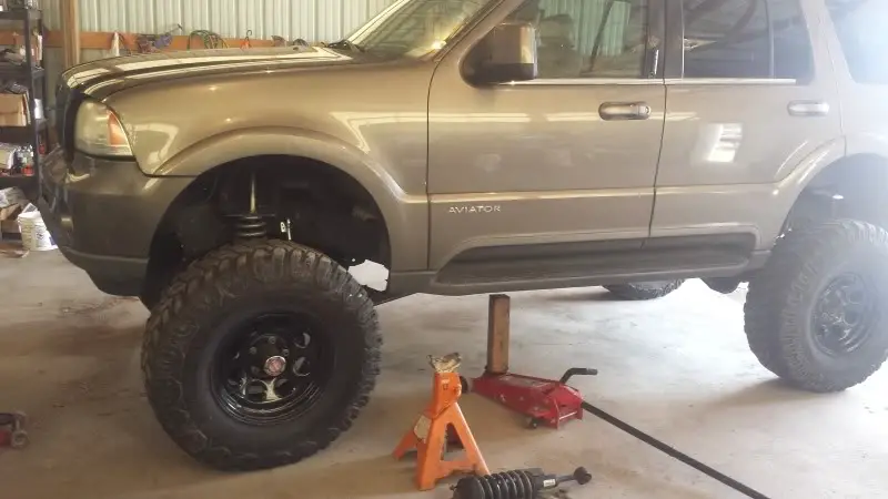

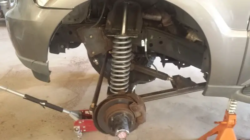

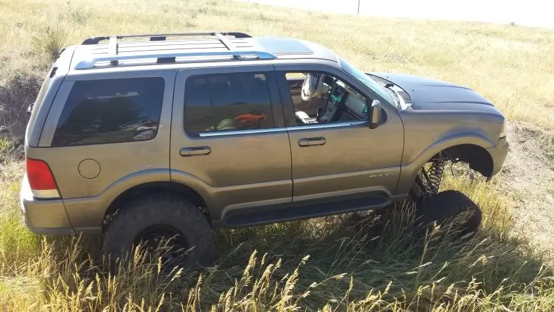

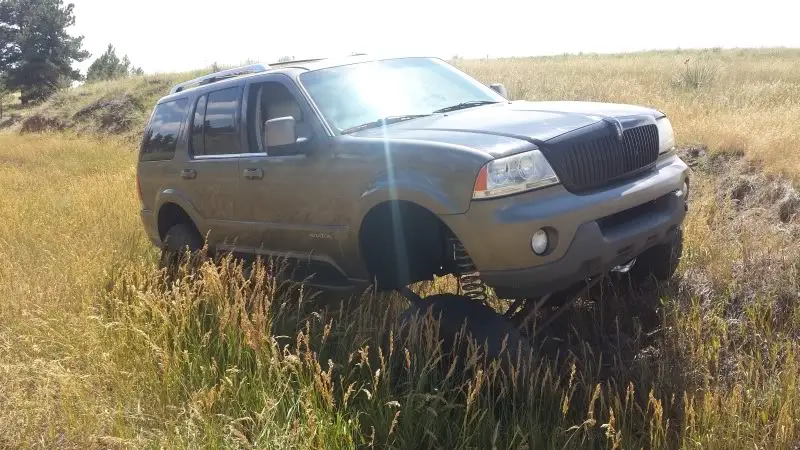

Had some time today decided to give Lazy some love.
Out with the struts and in with some coils...
My math was right on first try. I was cheesing since I wasn't 100% sure.
Front is only about 1/2 higher then the rear now. Which is fine since I plan on building a winch bumper for it. Pass side after lunch.

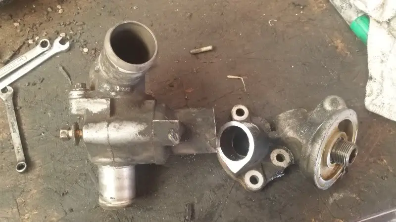

Had to modify the old oil adapter using the Lincoln adapter and an Explorer adapter I picked up. Using a small chunk of hose I was able to make clearance for the hydro lines for the steering box.
