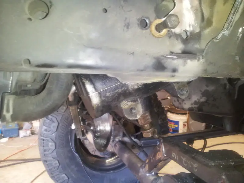

This rear crossmember for the control arms is going to have to go I believe.

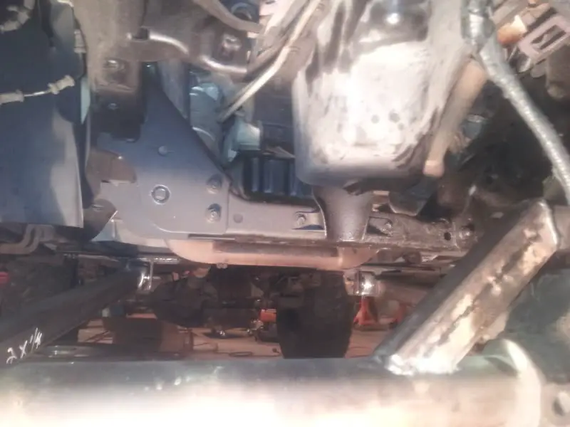

Lots of room under here now...
You can see there isn't shortage of room for steering box like in the 2nd Gen V8 trucks...

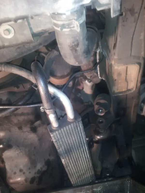

If you look at the top of the pic you can see the oil filter is right up against the steering box. So I am going to order a relocation kit for the filter. Same thing I had to do on the Merc. But it is not near as bad as the Merc for clearance.

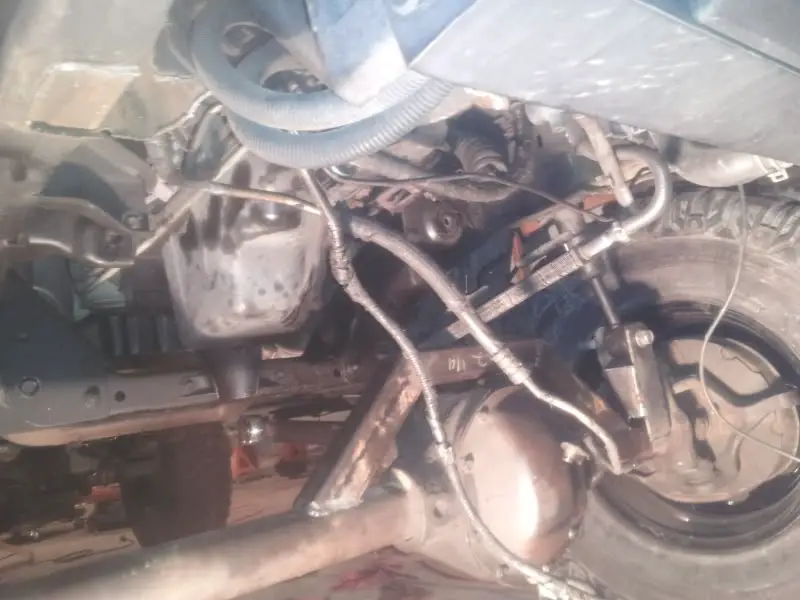

Going to have to build a brace for lower part of the box. Should fit nicely.
