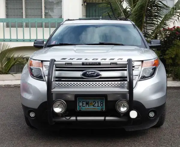

One of you with the push bar, could you please measure the distance between the two vertical bars... Curious to know how much space there is for mounting lights .
32.5 - 33"
will accept a 180w LED light bar, which is what I had planned until I found in the pile of stuff here two round flame throwers. Those I mounted on the lower mount bracket
picture.php
Behind the plastic cover for the front end, is a structural steel rectangular section tube as the main bumper. The Setina push bar uses a D shaped clamp for the top and bottom mounts on each side. This allows it to be a push bar (it is designed for police issue). With the extra side wrap, it allows Pitt maneuvers without vehicle damage. The push bar is not heavy, being made of marine grade structural aluminium. Distance between uprights is 33" and will accept a 180w 32" LED light bar. I have added round flame throwers to the lower bracket, which places the lens behind the bar, protecting it from damage. http://www.explorerforum.com/forums/picture.php?pictureid=7323&albumid=587&dl=1395917863&thumb=1

yes PB400. I had spoken to factory directly before ordering from a dealer, and found out that powder coating, in my case Silver, was an optional extra cost ($20,) Note, there are available in either steel or aluminium (I got aluminium due to weight considerations, and it is pretty tough - check my photo albums)
definitely the 30" light bar will fit. I believe there are identical models, not under the "Rigid" label available on eBay for less than $200. (specs are identical)
I see two options for mounting, either attached to the flat surface of the cross plate, or mounted low, on the brackets (where I mounted my spots)
The Setina, by the way, can be ordered with strobes or without, the strobe controller being built in, making wiring simple.. The no-police option strobes can be amber or white. Basic PB400 (no lights) runs a bit under $300, with strobes about another $200.
I did have my DRL activated. The lower round LED is wired to the DRL bulb wiring directly.
Glad to be of help. Come visit the islands one day.:chug:
Upper mount on a Sport.
Lower mount.

why is that? I had found this in another thread here, quote "I found it when I pulled the bumper. It is located on the driver side below and just next to the headlight housing. There is a sort of smooth patch next to the opening of the grill that is about 4 inches by 4 inches. In short since the mounting point of all the brush guards and grills are directly below it, you will never be able to add a brush guard or push bumper. Its probably why the police interceptors don't have the collision avoidance" http://www.explorerforum.com/forums/showthread.php?t=390471
If that is the case, looking at the Setina mount and position, I would really look closely, because the location suggested does not appear to be behind any part of the Setina push bar location. (I don't know exactly because I do not have that type of Cruise control). In my opinion, if I wanted the push bar, I would find a way to make it happen, even if I had to relocate the sensor and mount it on a cross bar of the PB400 - keep in mind that is only the way I think. Nothing is impossible with a lot of research and planning.
The radar sensing unit for the adaptive cruise control and collision warning system, for those that have it, is located in that area where I have placed the white dot.
