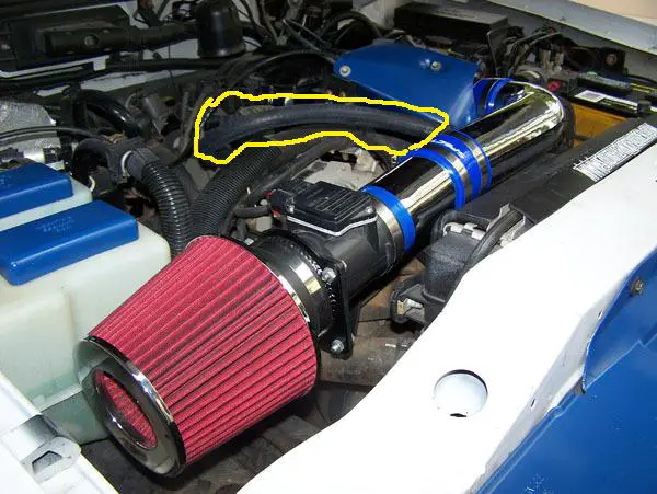

Hey guys been having trouble getting the oil breather tube to stay in my intake... (the intake was home made by me) is there a way I can just bypass this?
I circled the part in question
K&N and few others make clamp on breathers similar to your air filter. You could clamp one onto the valve cover side and just plug the hole in the air tube.
Exactly. There are quite a few makers of these, so look around.
They make plugs that look like rubber gromets, but they are solid. They should work and would probably look the cleanest.
cool, ima take a trip to the auto store and see what I can find.
