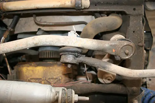

IF the arm drops your steering geometry to be flat, you shouldn't be getting any bump steer. Its virtually non existent on our X but our steering arms are perfectly flat.
Steering Linkage geometry by maniak_az, on Flickr
As already mentioned, you will need to re-align the front end once you put the new pitman arm on since it will change the toe.

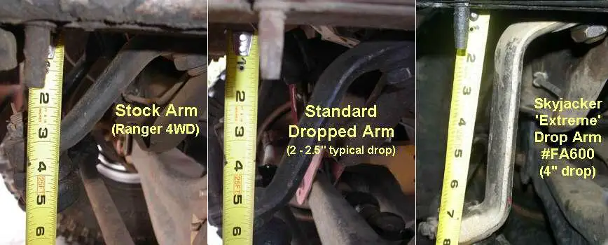

The Skyjacker FA600 drop arm would actually match up perfect with a 4" lift (it drops exactly 4" from what the stock arm is).
The FA400 arm should be acceptable for most people however (it's a fair bit cheaper), though it's actual drop amount is only 2" compared to stock, so it's not a perfect solution.

The FA600 arm (due to it's shape) does move the steering linkage back toward the axle a bit, which I've seen with some combinations of different brand aftermarket tierod parts, this can cause the linkage to hit at the pitman arm TRE, however this isn't anything to do with the lift, it's the steering linkage.
The FA600 arm is a true 4" drop, and is a perfect match for it. Seems if you have both a tie-rod and drag-link of the same brand (or stock OEM), the chances of them hitting each other are not as great.

Ok, I do NOT have the fa600. My measurements look like the middle arm in the pics above (standard drop pitman)..
