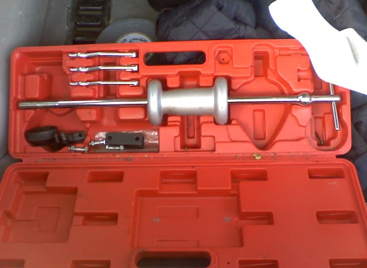

since the clerk was utterly clueless (pretty much read off of their display) and i don't want to have to go in tomorrow, does the attached picture have everything i need?
it is a standard "Slide Hammer, 2/3 Jaw puller set. OEM #27026.
It seems to be the right one, he says you can just flip the jaws around, will there be a clearance issue inside the axle or no?
thanks again.

That would be it... IIRC, both the round 'nut' and the three-legged piece that the fingers attach to will be threaded. You may need to play around with the positions of them, as the 'nut' is used to force the fingers outward and hold them up inside the bore of the bearing... make sense?
