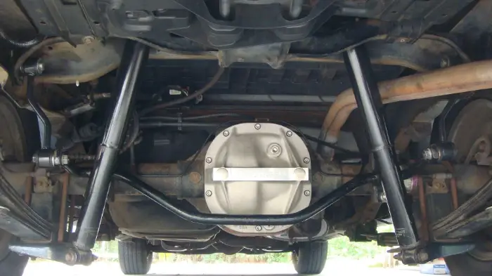

^ Exactly, perfect explanation. Here's proof of the driver side end link mounted lower.
Sames as right side. Double SS nuts are where I bolted the rubber bed mat down through existing ST drain holes.
Those driver side upper shock bolts are fun reaching aren't they? 13mm swivel head Gearwrench is the tool of choice.

I did, after learning about stainless galling from YOU. Man that stuff is messy, lots of paint thinner and paper towels. LOL
Thanks Phil. :dpchug:
These are the bolts I used. Very hard to find ultra low profile SS bolts of this size and length.

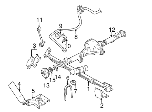

You need new lower shock mount pads and u bolts.
1 each for right and left side. 4 u bolts with nuts
look here in 1995-2001 rear suspension- items 2 (4) and 3 (1 of each side)
http://www.lmctruck.com/icatalog/fex/full.aspx?Page=66
You will need to support the weight of the truck by the frame, tires just barely off the ground. Cut the old u bolts off. You might need to replace the lower shock bolts also if they are rusted and seized.

Thanks so much Jon! - but Im a little confused on the assembly - the U Joints (2) basically attach those lower shock mount plate to the bottom of the leaf spring, but how would the shock attach to that plate? - sorry if I sound slow on this, etc.
