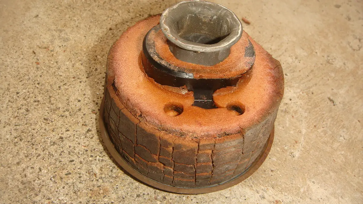

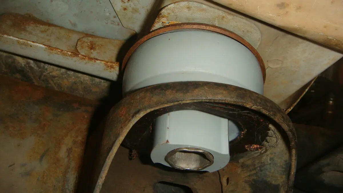

That'll do it. What threw me off was "REAR end clunk" in your title. Let me guess that it's orange colored foam. My upper "C" mount foam shrank causing the metal "hex" sleeve to flare and bottom out on the lower mount metal flange. Made an awful scraping, grinding metal to metal noise when turning. This is what it looked like after replacing only three years earlier. I installed much cheaper, but stronger Daystar (KV) polyurethane/kevlar body mounts this time.
OEM upper "C" mount is discontinued, but found NOS on eBay for a laughable $240-$250 each.
