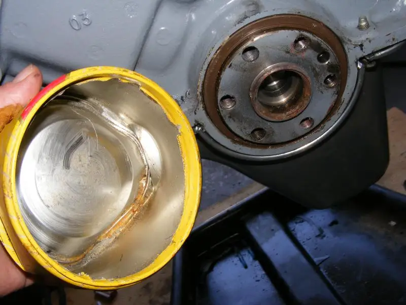

In my frustration I started looking around the garage and behold! An old can of Johnson's paste wax. I threw out the wax, and cut around the inner rim of the lid making a double strength ridge. The can was almost perfect, it got the seal on but it was a one time use deal.

Measurements are 4.25" od 3.75" ID and 2" deep would work perfect. All that is needed is a chunk of 4.25" pipe with a backer welded to the end.
A piece of pvc pipe might work, but you do have to hit it with something from the center so it would need a cap also. It would also need to be perfectly "square" cut.
What about using a metal pipe cap (black or galvanized metal) or a metal electrical box cover plate? You could drill holes in it then insert bolts to press it in without hitting it. Is the correct tool an OTC 7786?
what about a pcv or metal grease-trap piece of the approx diameter the kind with the screw-in/on cover? i'm sure there's something in the Home Depot plumbing isle that would work.

I was looking at the tool that you seat the seal on a thin walled pilot diameter, then it is slid over the crank and drawn in with two bolts.
I have access to a lathe and some limited amount of material and figured it would not be too big of chore to whiddle one out.
If you were to install via the tapping method, I would think pretty much anything with good enough diameters and a reasonable flatness would do.
