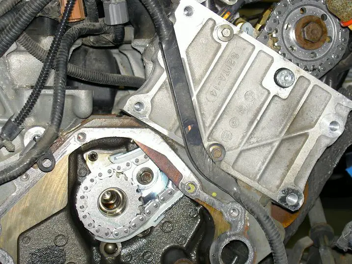

left cassette lower bolt photo
The photo below by CDW6212R shows the left cassette lower mounting bolt that is under the removed jackshaft sprocket.

My Haynes manual states the torque for the left hydraulic tensioner is 35 to 39 ft-lbs. My primary timing kit assembly instructions state the torque as 49 ft-lbs if reusing the original washer or 32 ft-lbs if using a new washer. The washer can easily slip out of position before it is tight and then there will be a bad oil leak. Apply some grease to the washer before placing it on the tensioner to keep it in place.
steadyhand
May 5, 2010
98
Missouri
99 Mercury Mountaineer
Well I I bought a large 18" chain wrench. This thing is without a doubt sturdy and will allow great leverage. It cost me about $50 but I'll need it later when I go to rebuild a 302. I also got the HB puller, but the problem is I can't find the m8 1.25x100mm bolts to fit the HB. I have checked the hardware stores and automotive stores and no one has any. I tried to find a threaded rod in the same size and so far no luck on that either. This is a slow process because a lot of the things needed can't be found very easily. Wish I had looked for it all before starting :)
2000StreetRod
Staff member
Moderator
May 26, 2009
10,595
251
Greenville, SC
00 Sport FI, 03 Ltd V8
chain wrench
I found a chain wrench online at Northern Tool Supply for $65 but couldn't tell if it was suitable. Where did you purchase yours? Let me know if it works.
You can use the stud bolts from your A/C compressor to pull the balancer. They are long enough and the correct thread. Just be careful that you don't break them by tightening the puller center bolt too much. Use the hammer and tap the center puller bolt head to jar the balancer loose. Tighten, tap, tighten, tap, etc.
