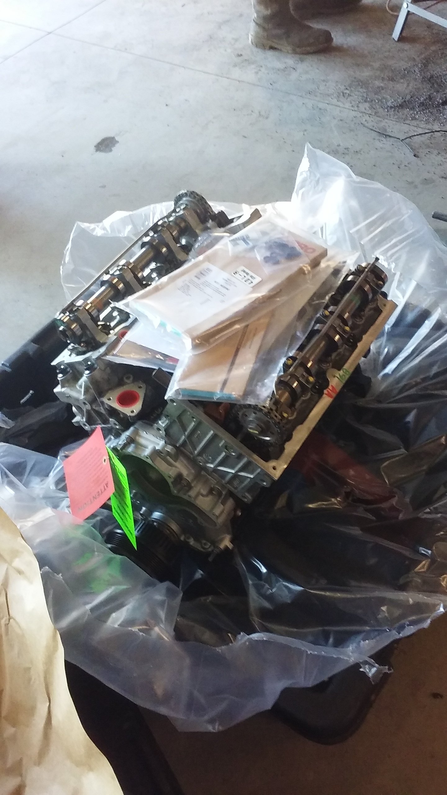

'03 Explorer 4.0 SOHC TC jumped, oil sprayed, going uphill under load. So which way have you all found is most economical? Engine swap(used), Rebuild, or remaned engine?
I got a remanufactured
It was easier than rebuilding
Not cheep
4 year 100000 mile warranty
Depends on how much your time is worth. Anything used should probably have the timing components replaced. Say 1500 for a running long block, probably 600 for aftermarket parts, a other 600 for the OTC tool and other tools, your looking at 2700 for a reliable used engine. That and the time to get everything right. How much for a drop in?
