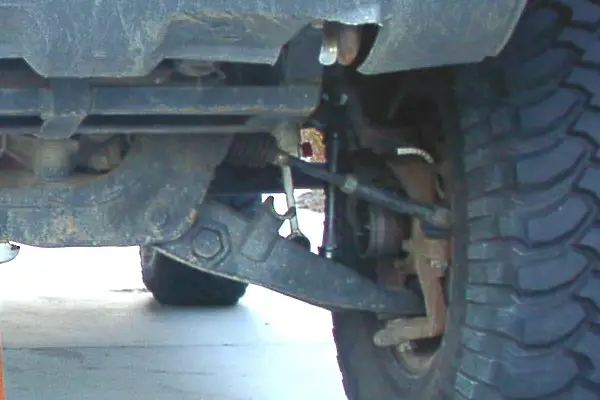

is there a method to the madness of getting those cv's apart like jefe did?
ive got one down to just the outer cup, stub shaft, and the internal splined shaft that goes into the cup that is normally covered by the boot. i removed the c clip and beat it like it owed me money and the splined shaft hasnt moved. anybody know any tricks, or is it just brute force and a vise?
I have never had the trouble you are describing. Once you loosen the axle nut (dont remove it all the way yet), remove the brakes and rotor, remove the upper balljoint cross bolt, and lay the steering knuckle down, the CV should come right out with a little coaxing :hammer: Once the stub is free, thats when you take the axle nut all the way off. (it will stop the end of the axle from getting bigger from the pounding) You have a gear puller or a big 3 jaw puller?

pos mounty, i dont think you understood my post, or it is possible my post didnt make sense.

OK, this I have done!
I used a 4 inch grinder to cut into the ring inside the cup. Kinda like a cage around the ballbearings. Get it in a vise. Once you cut it in 3 or 4 places, you can get all the ballbearings out, and it will fall apart after moving it around and twisting it. It took me around 1/2 hour a side.
Hope this helps

o'tay!, this is the info i was wanting. i didnt want to do all of that to find out there was a hidden c clip or something to make it all come apart lol. thanks...i can do this at work. looks like i will be able to drive agin this weekend......but only in 2wd:(
got the cv stubs cut off today. it took a lot less time than i thought. pretty messy though.
