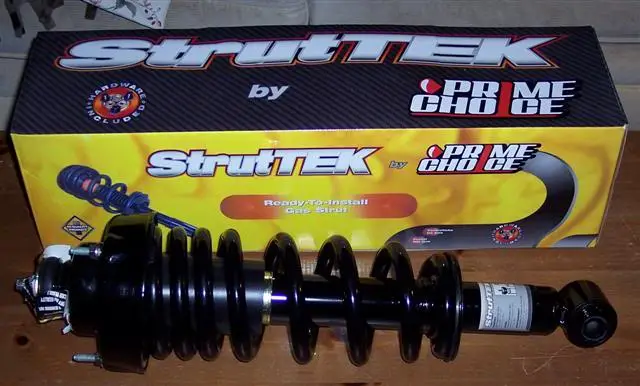

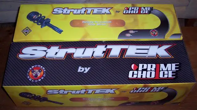

Changed mine with struttek. Was no big deal at all. They are inexpensive and you then have piece of mond as the old springs are known to break on this generation explorer.
I agree with rocco.
Welcome aboard cannon!! :salute:
Both my rear springs were broken & my front struts were leaking when I bought my Ex in Feb 2010.
Now I'm running the StrutTEK's on all four corners and have nothing but good things to say about them! The ride is awesome and the price is right. I can't compare them to the original struts since they were FUBAR when I bought my Ex.
The rears were installed on 11/29/2010 & the fronts were installed on 2/20/2012.
I love them. The ride is great.
Click here to find out more about the StrutTEK Struts.
