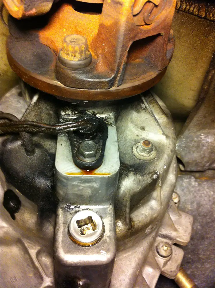

Yup, I'm pretty sure that is a transfer case leak right there. Right above the fill plug and
underneath the rear drive shaft. Looks like it wasn't the O ring that was leaking.
