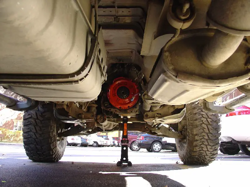

awesome pic! Looks like a centerforce clutch. I'm also jealous that you don't have to jack up your truck at all to drop the tranny.
