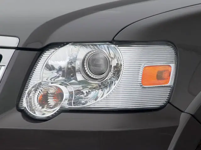

I'm shooting for my end result to look something along the lines of this:
Sadly that image was Photoshop'd otherwise I would just buy that headlight! :)
here's an actual one
