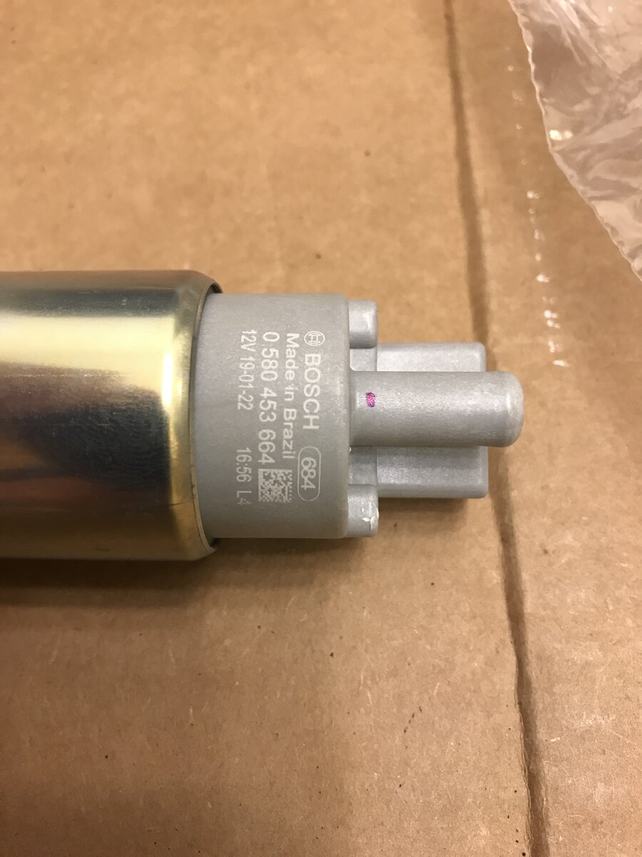

Strange... I just clicked on the link and got this:
**Information**:
-This is a brand new BOSCH Fuel pump
- Top Quality
- Sold in bulk without the Bosch Box
- Buyer will receive the fuel pump as pictured
-Comes with a 30 Day Warranty
-Direct replacement
-If for some reason you are not satisfied with your purchase, contact us and we will do the best we can to make up for it! We have thousands of positive feedback and are a well trusted company
-We have super-fast shipping
Oh, I just looked again and saw the Airtex stuff...
Not too concerned. It comes with a 30-day warranty. If it's not Bosch, I'll send it back. In the meantime, I am going to contact the seller and see what he or she has to say!

Does not sound right!!
If it’s sold without the Bosch box, it’s counterfeit. It’ll have a fake Bosch logo most likely. Or it’s a return. There’s not any good reason it’d not have the box.
Here is the wrong Bosch 69131 fuel pump I bought for my 96, and the Bosch 68015 filter, just you have something to compare the eBay ones to when you get them. My fuel pump is not the same model, so numbers will not match.
Message from seller:
Hello.
You will receive Bosch fuel pump , we are using Airtex catalog for application only.
Thank you.
Well, between the seller's clarification AND the 30-day warranty AND (I wasn't going to admit I fell for this 'cause I usually know better.) the two-year extended warranty I purchased, I think I'm covered.
You will receive Bosch fuel pump But then, there's that Russian syntax...

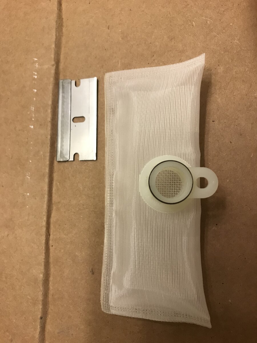

New pump mostly installed, a couple of details outstanding:
  • Can I use my existing adapter harness? The new one fits only on one end.
  • Retaining washer for securing the strainer-- Not having any luck pushing it in place with needlenose pliers. Can anyone suggest a better tool or method?

"Retaining washer for securing the strainer-- Not having any luck pushing it in place with needlenose pliers. Can anyone suggest a better tool or method?"
Place a large socket upright on ground (around same diameter of ring area to support retaining washer) ...place strainer and washer in place/line up on socket....and push down/smack assembly down on socket.
Diabolical invention! No room for pliers. Small enough to conceal itself behind a lentil, so thin I don't dare breathe, so flexible it ricochets across the room at the slightest provocation! It's come to this: I'm down on all fours, sweeping the kitchen floor with an earth magnet! Then I remember these from my camping days:
Meanwhile... the day has come and gone., so it's tomorrow after all...
Thanks, but the space is too tight for a socket.
