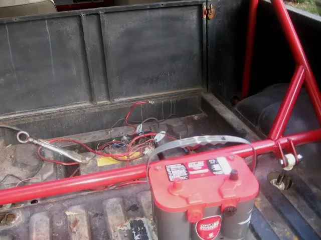

About time to install the Red Top and get rid of all that temporary wiring :eek: Would love to have two batteries but that will be later. I really don't much in the way of electrical accessories anyway.
Get this battery down in there and secured. Might even do away with that grounding quick disconnect:rolleyes: Then install the top battery box cover.

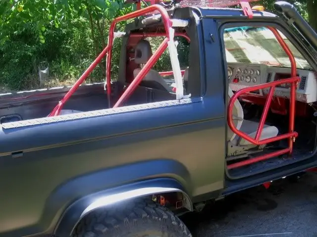

Now this build needs a paint job that goes hand in hand with the build. A utilitarian Satin black is fine. I've done scratched it already and don't even have tags yet:eek:

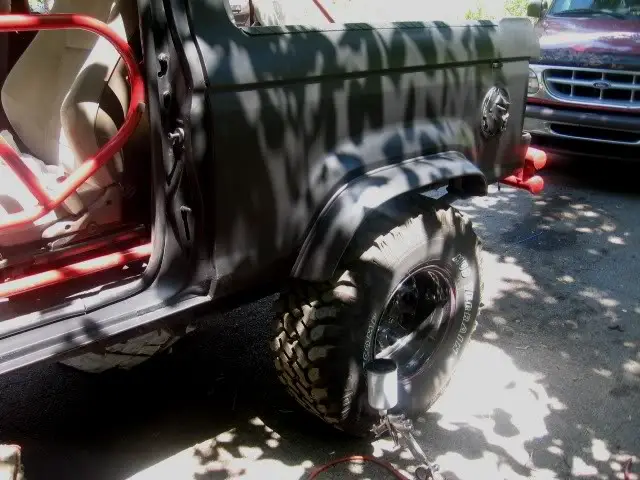

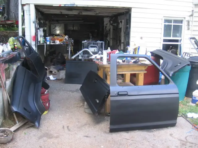

Look at this carnage.....freshly painted body parts everywhere. Good thing a car did not come down the road, or I'd painted it also :D I was impressed on how easy it was. Now this is no trick paint job and I know I'm not even worthy of caring a pro. painters spray gun. Got a little heavy handed in some spots. So I guess I'll just let dry, sand and hit it again. But it's fine for this rig.
There's my new toy at the bottom of the tire. I just did that side. A whole lot better looking then the rattle can look.
This picture is about as true to life looking as I could take. Paint is only about one hour old.
Before

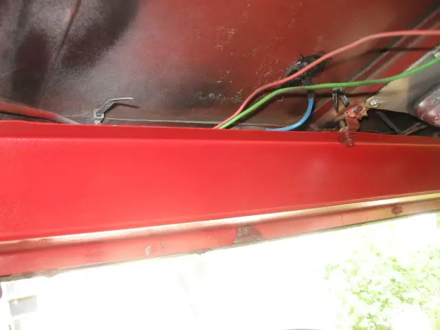

After. And it's still wet. That blue wire must have fallen down after I painted, or it would have been Satin black also. HA HA

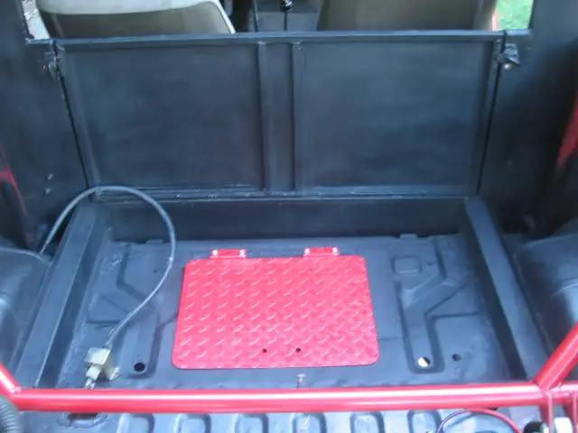

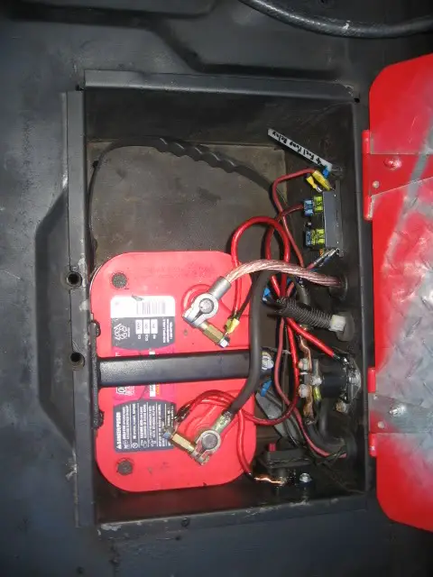

Finally this thing is coming to a close as the first part of the build is finishing up. Kinda sad really. Ok, I'll snap out of it. There's my Optima Red complete with starter solenoid, auxiliary fuse box and to the far upper right hand corner a 150 amp circuit breaker. That circuit breaker can also be used as an on/off switch and is weather proof, so they say :rolleyes: .
One of the main goals was to have a sanitary engine compartment. "Old School". When I open the hood my eyes still go :eek:
Check out that battery hold down. It's a piece of oval metal that was about 5' long that had a tee at each end. When someone trashed this I just knew that somewhere along the build this could be utilized. Just cut to size and welded two bolts thru the holes at the tee part. Then fasten nuts from underside with out having to have a wrench on the other side. Used 3/8" all-thread to secure other end to bottom of box. Still need to put a small piece of angle at left side of battery at floor. Still have more room for other devices.
All tucked under that red cover. Just need to find the two bolts that went thru those two holes in front :D . I was able to utilize those two stock bolt holes complete with the two bolts complement of Ford :salute: .
This is an older pic but that large black lid you see will go over the area boxed around the red cover that is now over battery. This will give me about a 4" enclosed area for recovery, tools or other gizmos. That recessed area was also complements of Ford. Now when closed it will be flat with rest of bed.

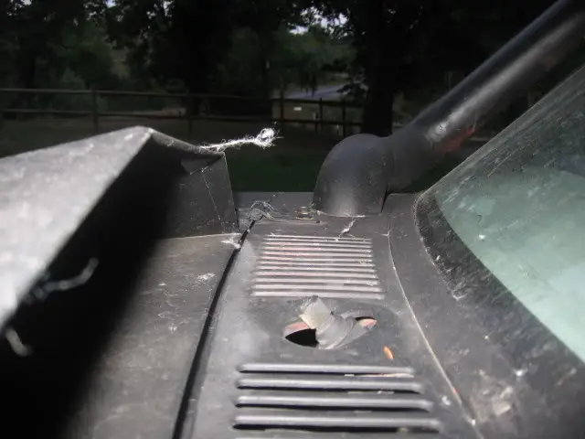

Check out this picture. I just was riding the beast around checking on some suspension stuff. Parked it and around 20 minutes later noticed these little bits of cotton strands that came off rag standing straight out. Hmmm. There was so much heat coming out of that hood scoop that they were standing straight out. If you look at the hood cowl in the far back there is one there that is flying up. Remember that I opened up that cowl area to the engine compartment also. When I put my hand there if felt like a little fan blowing. Now this is when it's standing still, just imagine moving along the highway or trails. Bet this winter there won't be too much ice on windshield :D

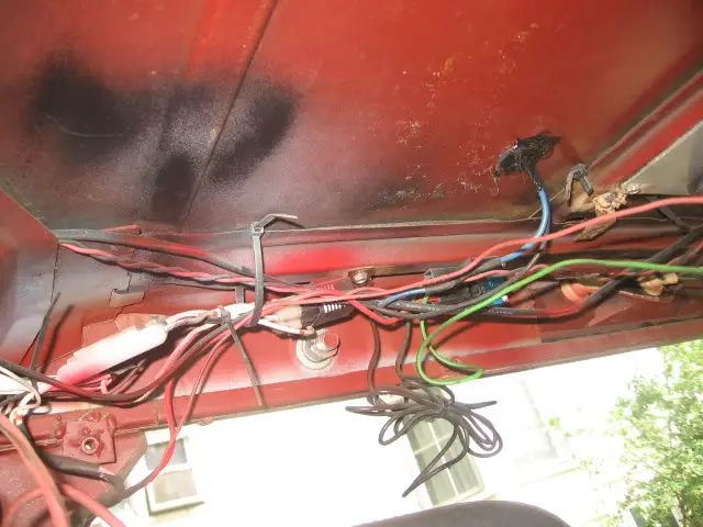

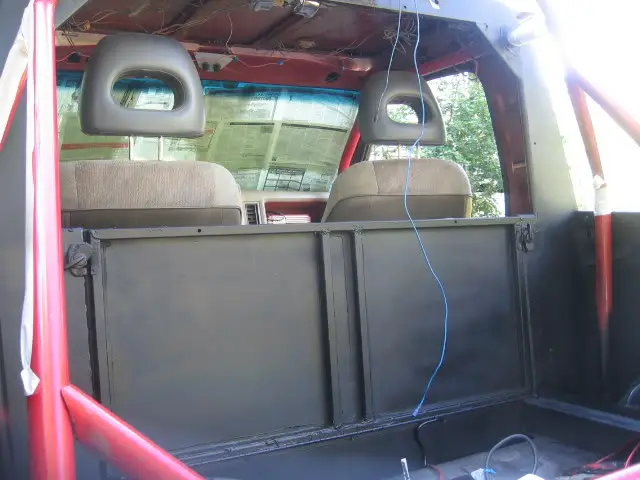

Need to start doing something about the inside of roof. that's the back of roof above seats.
Made this little bulkhead out of sheet metal. It covers those relays and most of that mess in the back. The inside roof really gets hot with that black paint. I have some of that thin reflective insulation that I'll glue up there, then need to find some kind of covering. May just go to Lowe's and see what they have. Any ideas out there?

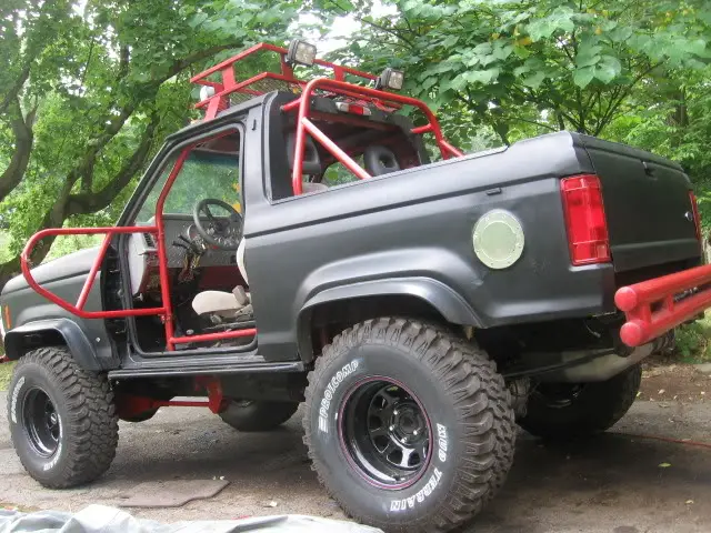

Here's a pic that shows the tailgate down. Some days I'll just remove, like when doing trails.

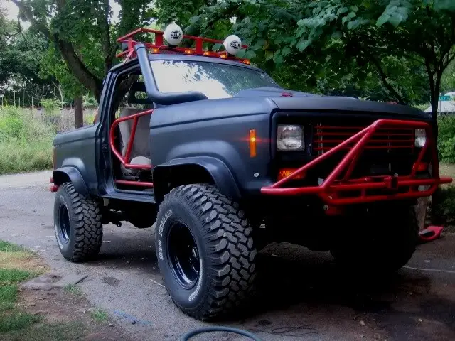

Here's a different look. The truck reminds me of a giant Tonka Toy.
Or more appropretly.....A boy's toy :D

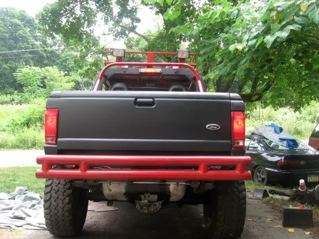

Got all the brake lights including that 3rd light working. Getting closer for that inspection.

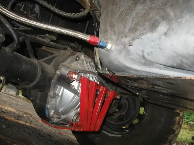

Skid Plate Time
missin a lug nut on the back tire?
OK guys. Picky picky picky HA HA.
Actually all four tires are missing one lug nut.
And now the rest of the story. Since I'm always taking these tires on and off while I'm still building it. The fifth lug nut is one of those locking kind that you need that special adapter to get it off. Well this became a PITA and now you no the rest of the story. The fifth will go back on later.
410 you were the second guy in the same amount of days that mentioned about the skid plate. The first was an old man who knew nothing of 4x4 and just walked up to me asking about what was I building. I told him about it and the first thing out of his mouth was, "don't you have to protect that gas tank". Then you come along about the skid plate. So I immediately stopped everything and bolted on that damn skid plate :p: And while I was at it, bolted on the diff. guard. :thumbsup:

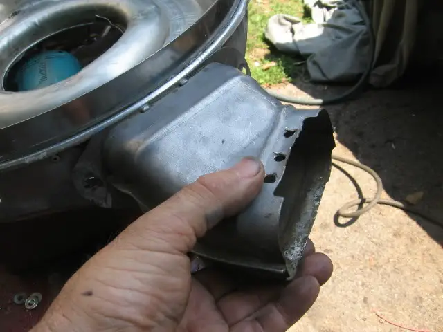

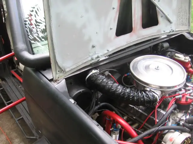

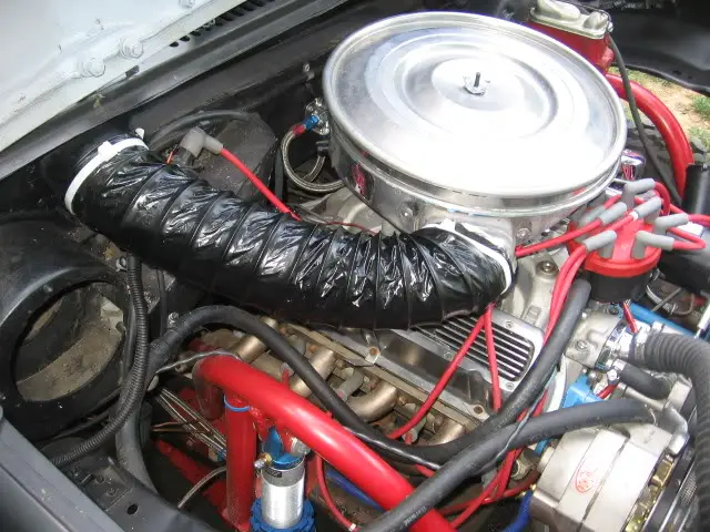

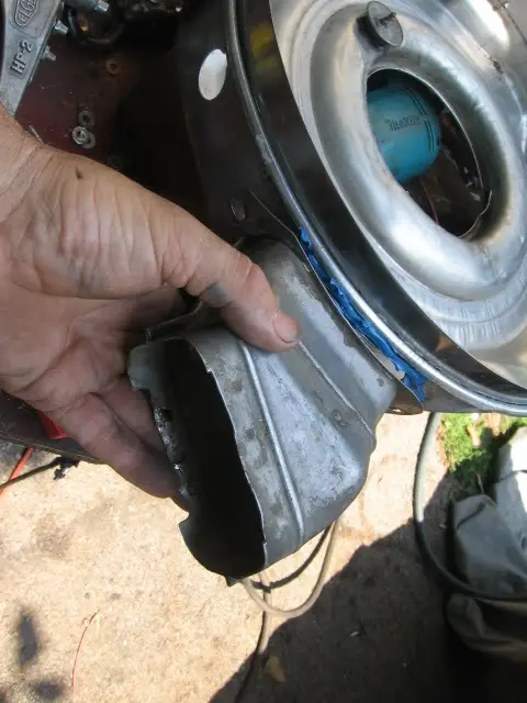

Going to hook-up the snorkel. This is the base of the air cleaner. The snout points down and toward fan.
What I did was to drill out the rivets that hold it to the main body that holds air cleaner. Flipped it around so now it points up and toward firewall. :D
It's not written in stone that I'll keep it this way. But it sure was cheap. Now it's also going to act as a cold air induction system also. I'm talking real outside air temp. None of that short ram induction that still draws some of the engine heat. With the hood scoop and window cowl louvers letting that hot engine air out and the cold air induction, hopefully this engine will run cooler.
After looking at this the more, I'm thinking of relocating that part that I flipped around more to the back of the air cleaner and running PVC or sheet metal duct to the firewall connection. Then just patch the hole in the air cleaner where I took it off.
