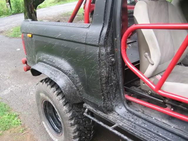

What ya know, it fianaly rained and I got a little WV pinstriping :D . The only problem was that I have no inner fenderwells and that mud gets slung between outer fender and body all over your arm. Not that, that is a bad thig :D . But some of that mud is gravel, ouch. So my solution was little mud flap connected to the removable fender.

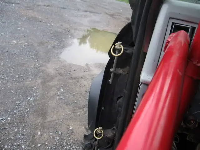

Here you can see the gap between fender and body. You can even see the tire between the two.

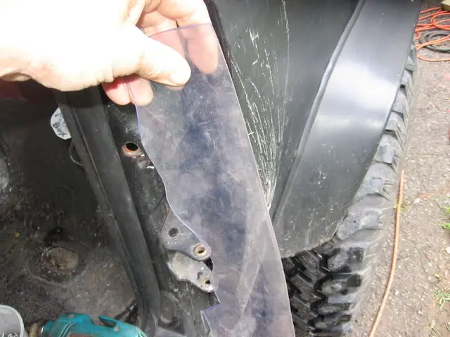

Found some clear heavy vinyl about an 1/8" thick. Just cut to shape and install.
Done :D
nice work! The fiberglass fenders I have do the same thing, but my doors and door hinges stop all the mud and snow.....for now

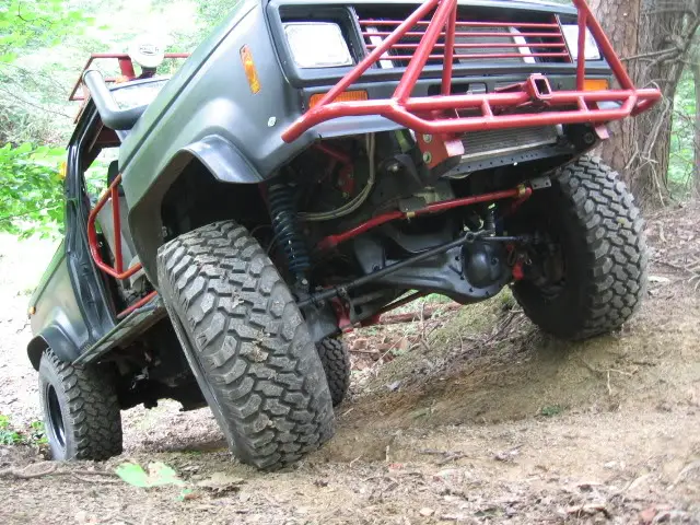

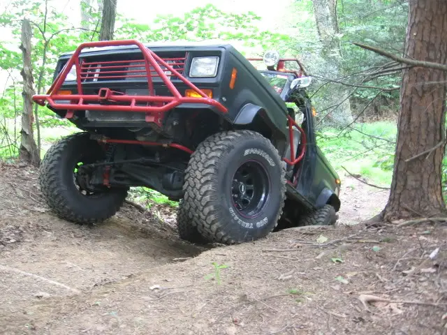

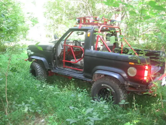

Thanks 410. Here some trail pics. Nothing great, but had to start somewhere, It was more of a shake down run then anything. But did find out that some things needed looking into as expected. LOL.
Well at least there's no pavement. This farm has a lot of woods, fields, hills and one stream. Plenty of mud when it rains, but no rain yet.
Nothing challenging, just some nice trails.
This is the stream I mentioned.

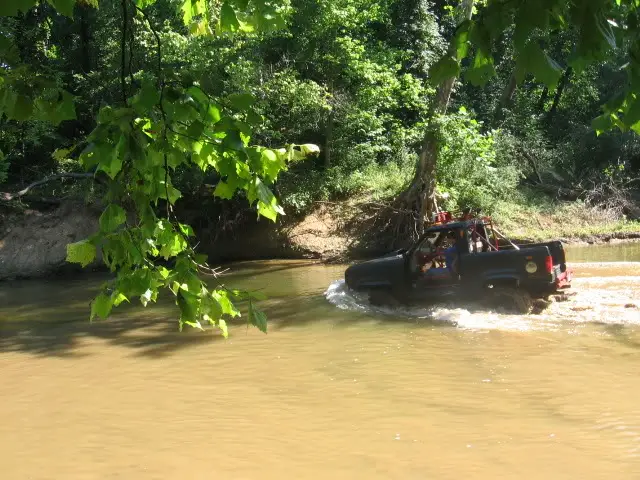

http://smg.photobucket.com/albums/v81/honda2nr4life/swamp spider/?action=view&current=MVI_5452.flv
Not much of a crossing but, hey had to start somewhere. Going to have another 4x4 with me next time and do some more challenging stuff. But it sure was fun anyway.

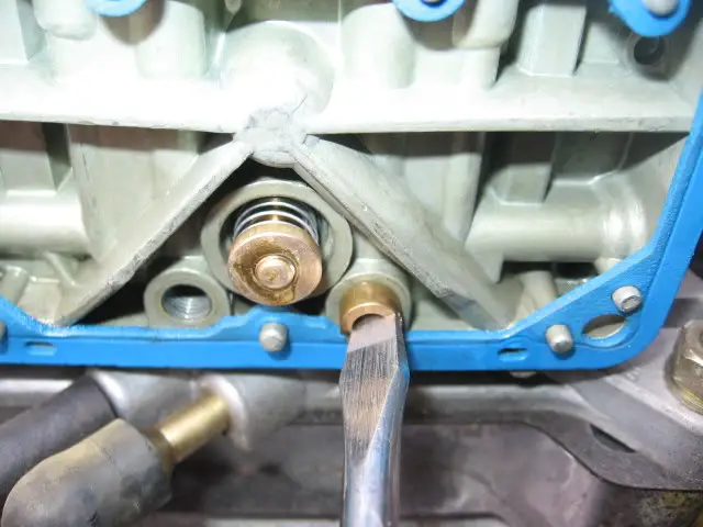

Noticed that the plugs were running rich. These Holley's are jetted for sea level, and since I'm up about 2000 or more feet I went to one size smaller jet. This should lean down some.

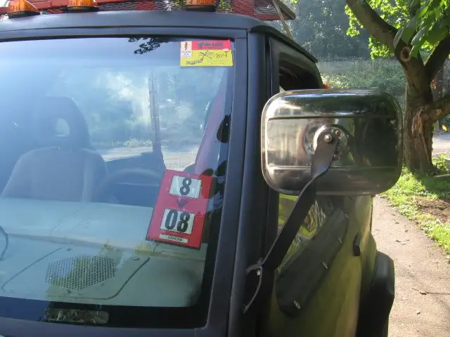

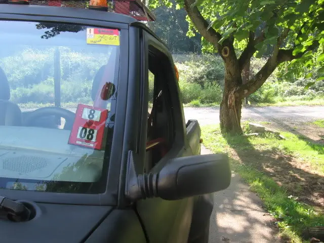

Made a mistake putting this large a mirror on and mounting it that high. It blocks out a lot of area, especially when making a left hand turn. Almost ran head on to a car that was coming out of Burger King:eek: when I was making a left turn into the place. Also I noticed it blocked to much during some of my trail rides.
So out comes grinder with cut-off wheel and on goes another mirror from Auto Zone. Just one of many things that need attention while I get some riding time. :D
I really like the looks of this mirror. It flows with the body lines better.

explorers have a foam piece wedged in between the fender and door hinge area--maybe one of them wedged in behind your home made flapper would help--
I'll check that out on my 97 X. Thanks for the tip.

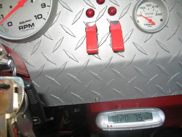

Oops, forgot to add this to the above post. Thought this added a nice touch. Clock with out side temp. Only $12 at Advanced.

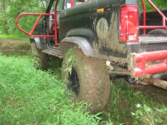

This is the first time my wife wheeled it. She loved it. This is the only place I've been so far. It's on the farm that I hunt on. Kinda like a proving grounds. But there are no rocks :( . I'll find some somewhere. Not that it's built for any serious rock climbing.
