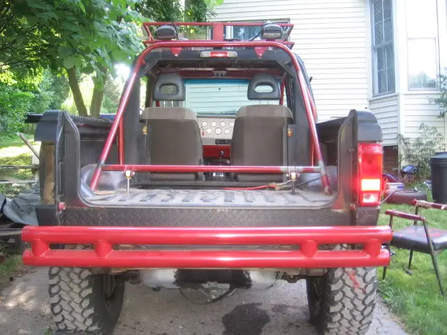

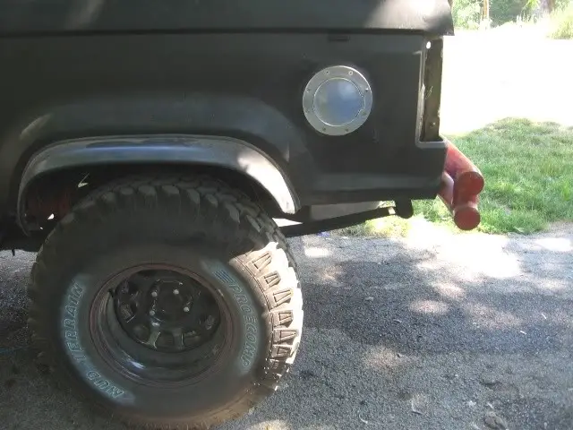

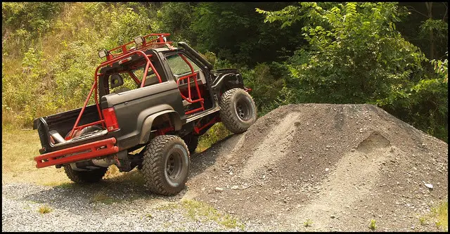

There's a pile of gravel in a vacant lot next door. Just had to drive one front wheel up on top while the other was flat on ground. It was the first time this thing was flexed to any degree. It was cool, first thing I noticed was the rear tire was stuffed up in the wheelwell with the Flexy Flair made by Pacer was doubled up on itself and pointing back up into the wheelwell at the extreme end towards rear bumper. Going to cut some of that rear fenderwell that turns down in rear. Not so much the curved part but the level part that runs parallel with road. Cut this up a few inches.
Your so right about finding out little things. That's why I'm doing some of them right here near my house while it's still not tagged.

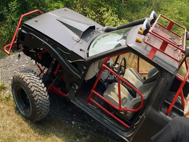

Well that pile of gravel was neat, but there's this little hill in front of my house that goes up to the railroad tracks. It's been taunting me since the build. Not much of a hill but somewhat steep and made of this loose cinder stuff that I guess the old coal trains used?
Just have to see if all the fab work is going to handle any stress at all. And besides it's fun. :) :) :) :) :) Just imagine if it was yourself sitting in that seat and drove it stock for so many years, Then the next time you turned the key it came alive to a totaly different beast. :eek:

Well I don't have one of those ramp thingies 410, but I do have my neighbors gravel pile to check out some flex. Hey, never seen a pic of my truck on that angle before. Noticed that I have to tie back in those roof cage light. Among a hundred other things.
The truck in this trim is about a thousand pounds lighter then a stock bodied B2 with trail goodies. And I must admit about a thousand time more fun then when this B2 was bone stock :bounce:
One other thing is the Off-road Holley carb has worked great at all angles. So far.
Was wondering how the cage tied into the frame and cab would do.

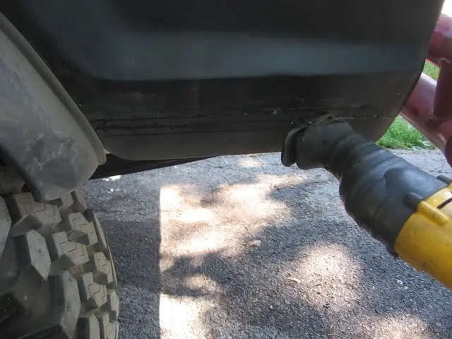

You can see on the rear Flexy Flair the mark where it was tucked upinside the wheelwell. I'll trim about 4" up from the bottom of right side of that wheelwell and then test it out again. Testing is so fun.

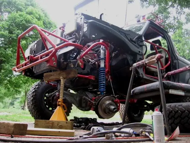

I called my friend at Anderson race cars in Winchester Va. and I mentioned about some front coil springs for the Fox shocks. He said come on down. So he might be able to set me up instead of the West coast co. He said the same thing as regard to weight and shock anglelation. So that's where I'm off to this morning.
To save room in the exhaust pipe build, I noticed flowmaster has a series 40 muffler that has two in and two out. Might research this one as to size and see if it's more applicable to the build. Love to get this ready for Carlise Truck show in Aug. Really don't need no exhaust up there any way to show.
Ok, finaly got the right coils on the shocks and took it for a short ride. Very nice to say the least. Another hurdle out of the way.

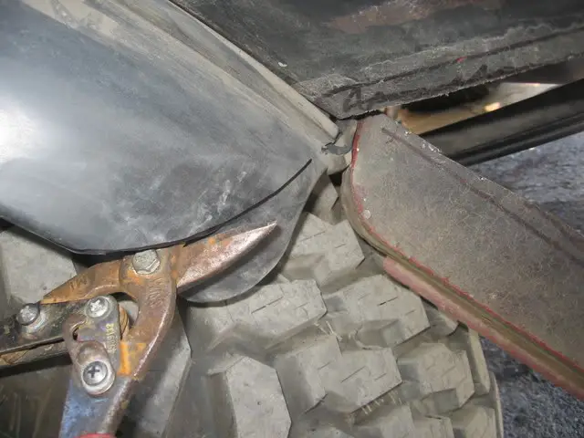

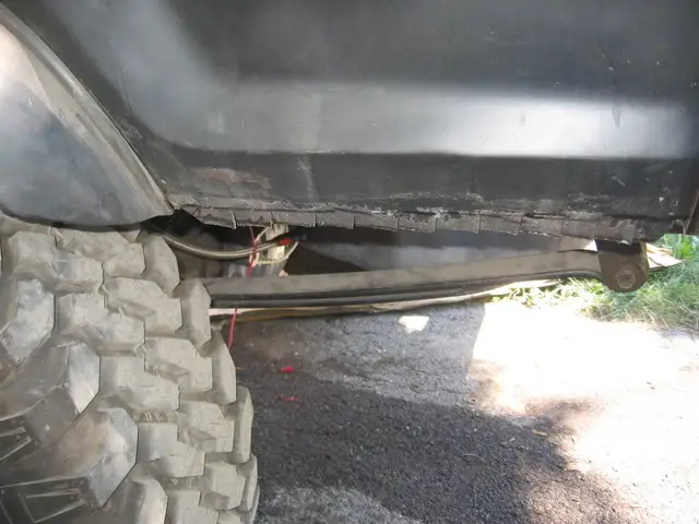

On that little flex pic where I had the problem of the flair tucking back into itself hopefully wont happen again. Going to cut off 3" from bottom and that will take some of the radius off the wheel well.
On the metal I cut about 1/2" below scribed line and then fold back. Oops, I'm goofing up cutting the flair. I forgot to cut a 1/2" above the line. Drew the ling in the wrong spot. H AHA
Now I re-cut the flair and then notch the metal for fold.
These old tongs are nice for this.
Now I have some more clearance

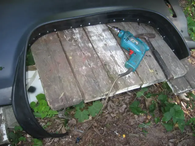

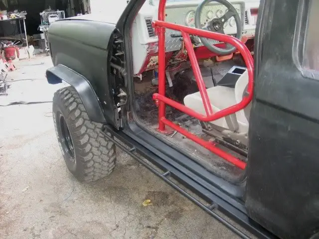

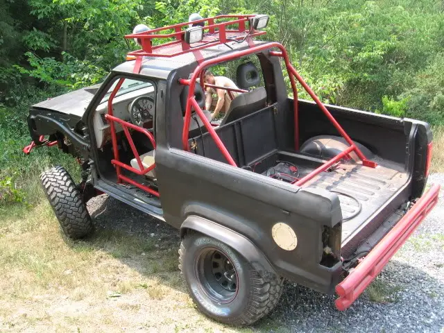

Installing some of those Sexy flairs on the front fenders like I did the back. A tad bit long. Did I say Sexy, I mean Flexy flairs by Pacer.
Won't be much longer untill I'm ready for inspection. Going to try to make it up to the Truck Nationals at Carlise.
