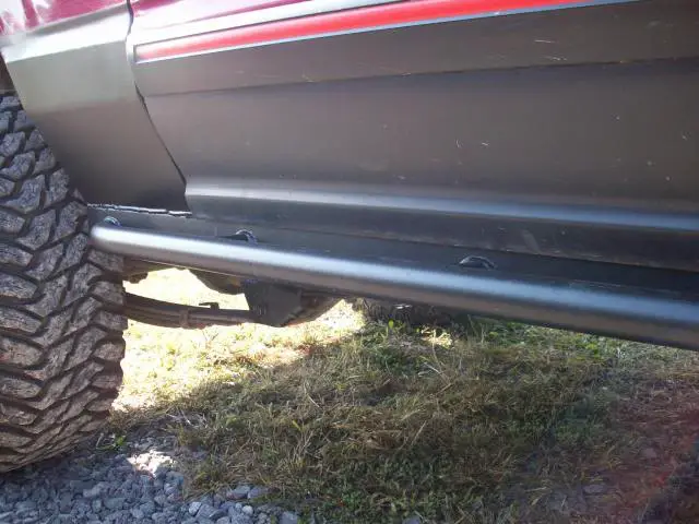

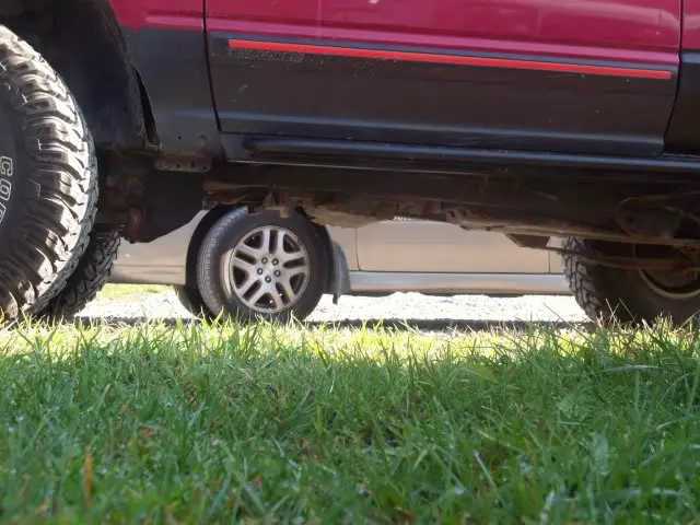

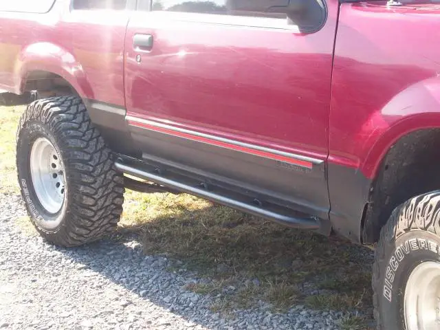

i dont have a how to.. but i do have some pics..
HEY long time no talk to!! Thats what im looking for is a set up that goes right under the body light like, tight to the doors... my rocker panels are umm gona.. past gone... you have any off pictures?
My sliders replace the rockers, which were also gone.
yeep thats what im looking for. something simple but works, doesnt have to stick out to far or at all, i like foursports, just not good with a welder or have access to one, thats why im trying to get some pics, so i can show a friend..
what gauges did yall use

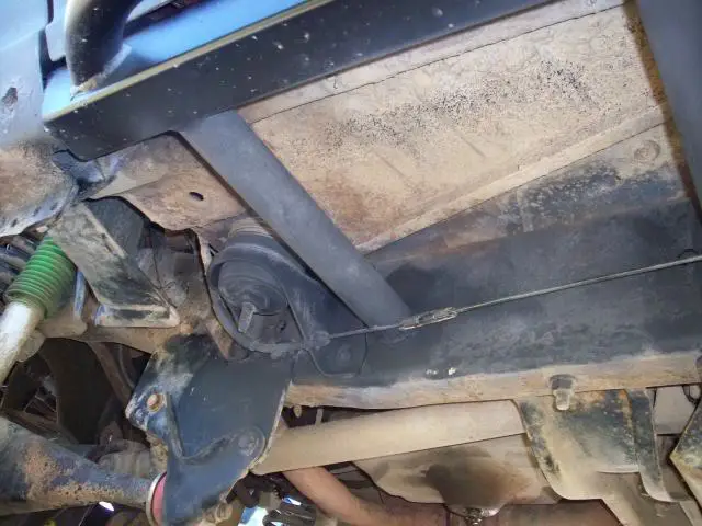

those are all the pics I have.. my rockers were rusting out, dented from landing on rocks, the front of the rear wheel wells were returning to the earth. friend of mine cut out the rockers, cut the wheel well, weleded 1/8" plate from the body line down, square tubing went in place of the rockers.

Do I understand this right?
The bottom of the rocker panel is now a flat piece of steel with the square tubeing welded to that. You then have tubes running from the frame to the square tube. Basically it ties the frame to the body?
If thats right, any new issues with noise or body/joints ripping?

Yep, thats pretty much it. It wasnt something I had any control over, i kinda dropped the Explorer off at a friends and he made magic happen. I havnt had any issues or complaints, there is some noise if I have the truck bound up pretty good, otherwise cant even tell. I've put them through some rough situations and have held up fine.

It can be good and bad. Good, as it it keep you from ripping the body at teh firewall (Rick did that already), just like a roll cage will do.
Bad is if the body isn't strong enough to keep everything from flexing you may rip the body elseware (sp?).
