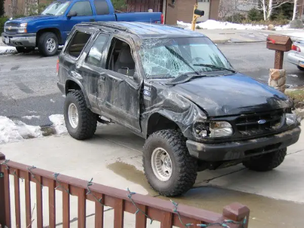

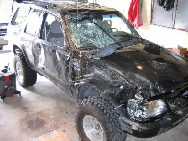

Got her home, and she drives perfect. Started up on the first crank. Still waiting on my insurance.. and im starting to get a bit angry. Anyway.. here are some updated pics, still ot sure what I will do.

:( I think it still looks real tough.
Are you going to be looking for sheet metal?
Not sure yet. Depending on how much insurance will give me for it, and how much the buyback is I may have to part it out to recover. If they give me enough, and I buyback cheap, then I may fix it up. Needs new fenders, hood, pass door, and work on the roof.
Sorry to here that premier. But dam dude that thing still looks mean with half the side bashed in! I say fix the window and thats all. HAHA
Man, those pix remind me of our rollover.....In hindsight, we wish we had kept it and fixed it....
