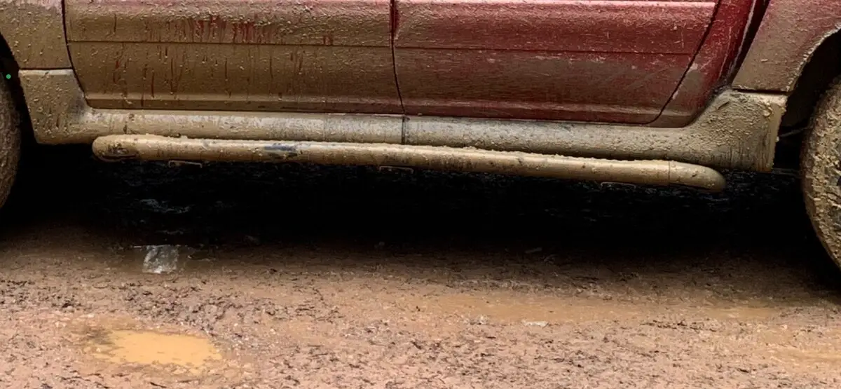

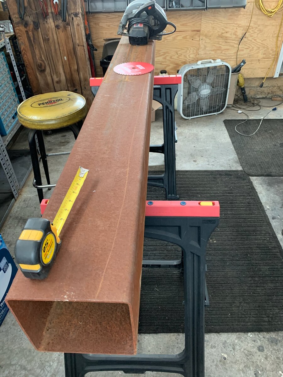

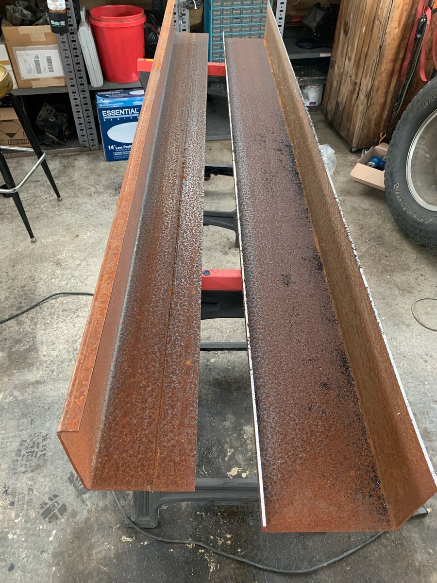

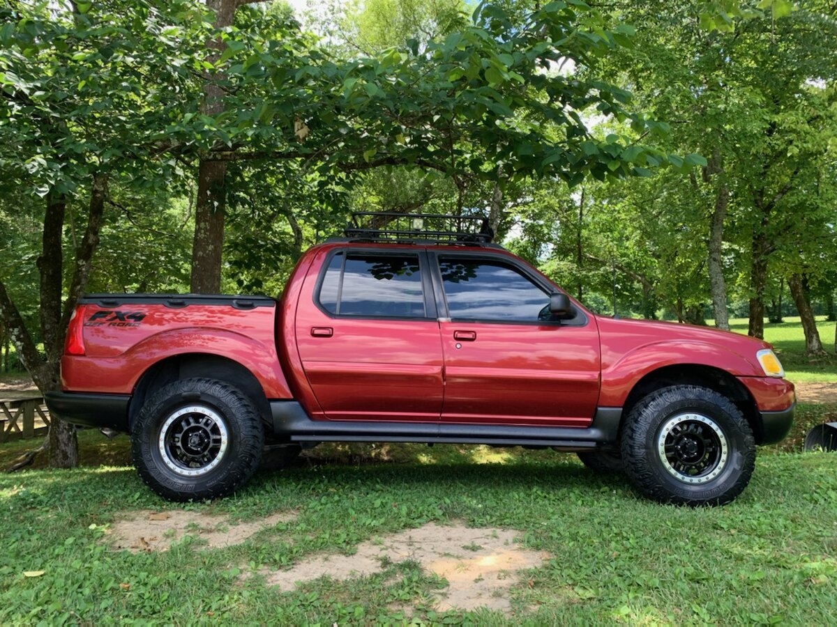

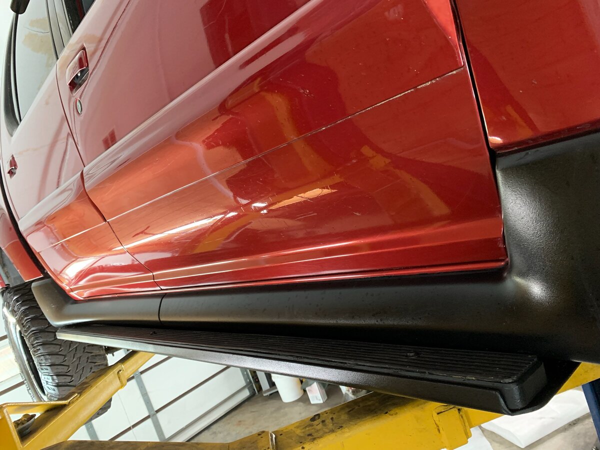

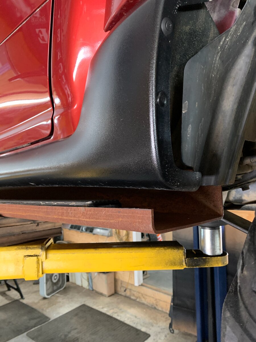

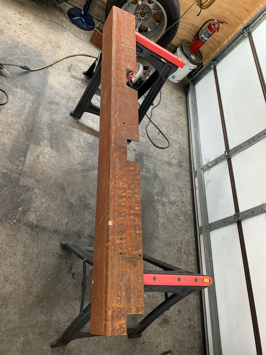

Over the years I have bent and ruined several sets of side steps and brackets off roading. I have looked at several rock sliders but did not really like them. I decided to try and come up with something on my own. After thinking about what I needed I wanted something smooth on the bottom and strong. After looking at everything I could find on line and in magazines (yes I still get Four Wheeler magazine) I had a vision of using a 8 inch square steel tube. Below I will show in pictures what I have done and am very happy so far. They fit nice and tight. The steps I mounted on the pipe are from some side steps I bent the brackets up on. I will try it off road soon and report back.
