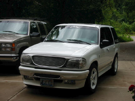

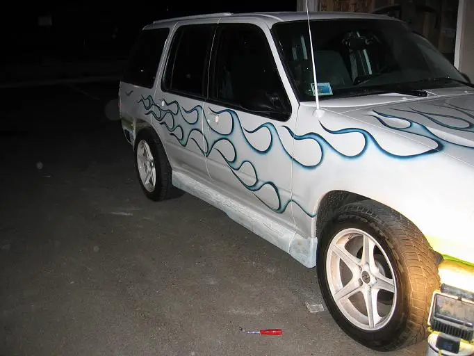

these are some random pictures of it.
i got the wheels from wheel-replicas.com something like that.
i run 255/55/18 up front (saleen size)
and 285/50/18 in the rear
i love it- nothing else i can say about them

Expo5.0, looks great in those newer pictures. What did you do in the left rear to make space for the wheel? I removed my upper link to move the E-cables inboard. I have 18x8.5's with a 35mm offset.

there is actually just enough room stock- it will rub on the inside of the wheel well if i go over enough of a bump (just a tiny bit) also, i moved the e-brake stuff as well.
