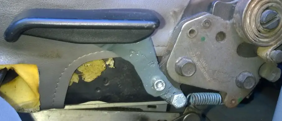

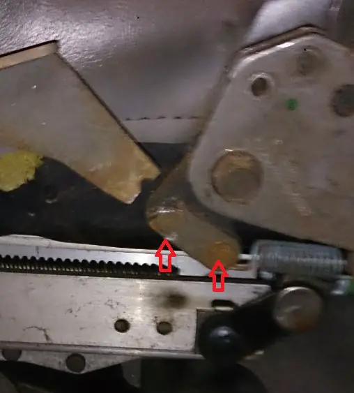

What to do with this fold handle? I bend it back and this thing bends after couple of times I jump into my vehicle.
Eventually it's gonna break.
What can I do?

I think maybe weld a metal plate to strengthen it...
To strengthen/weld it with a metal plate you have to drill out two rivets,
the hardest part. Make two inside threads use good bolts.

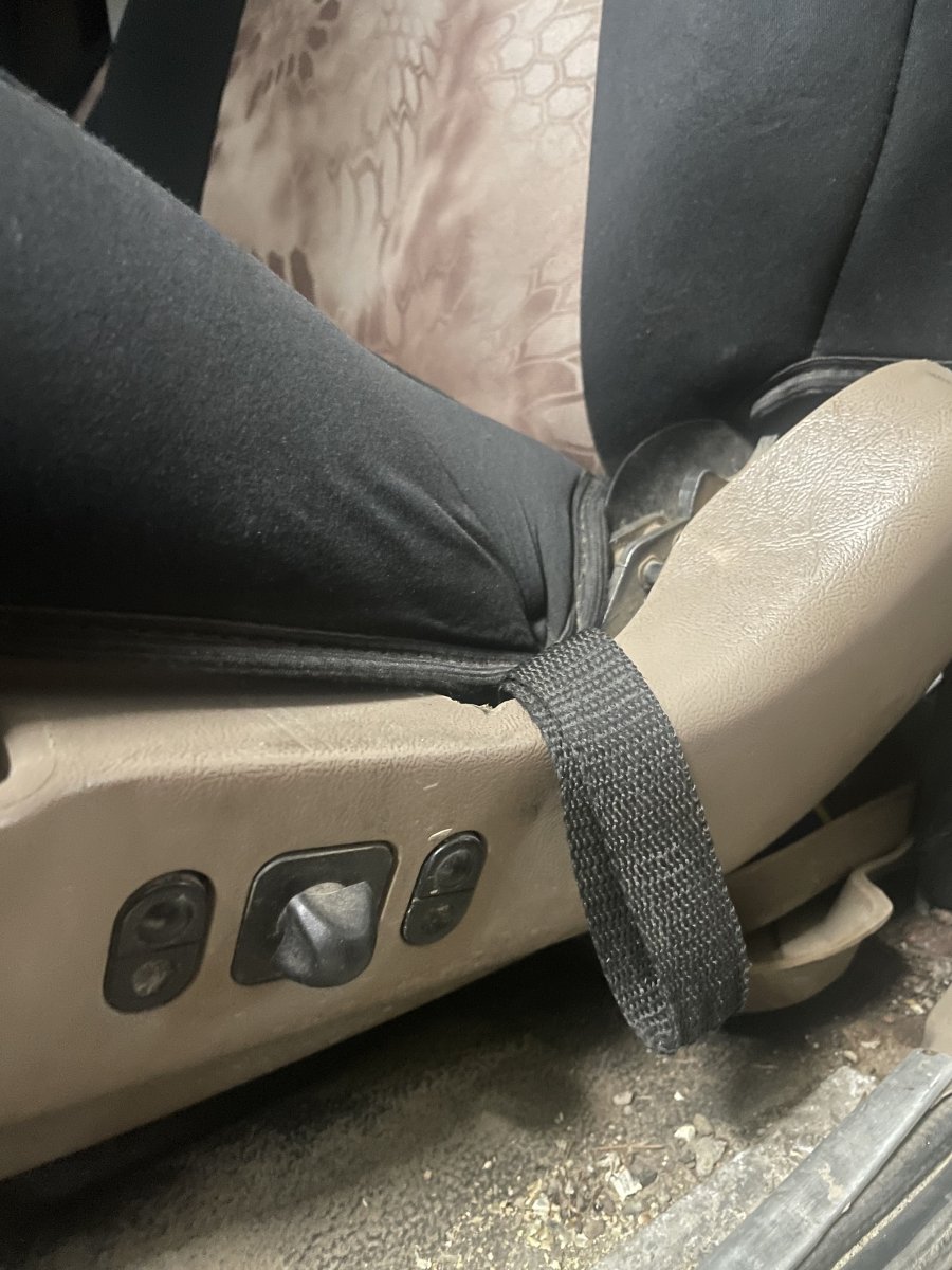

Once they break I replace them with a strap
I use black webbing material from an old backpack and make a
Loop. I secure it to the metal hinge with a piece of baling wire … now I can enter and exit the seat without worrying about catching the metal handle
The strap Has worked awesome for many years

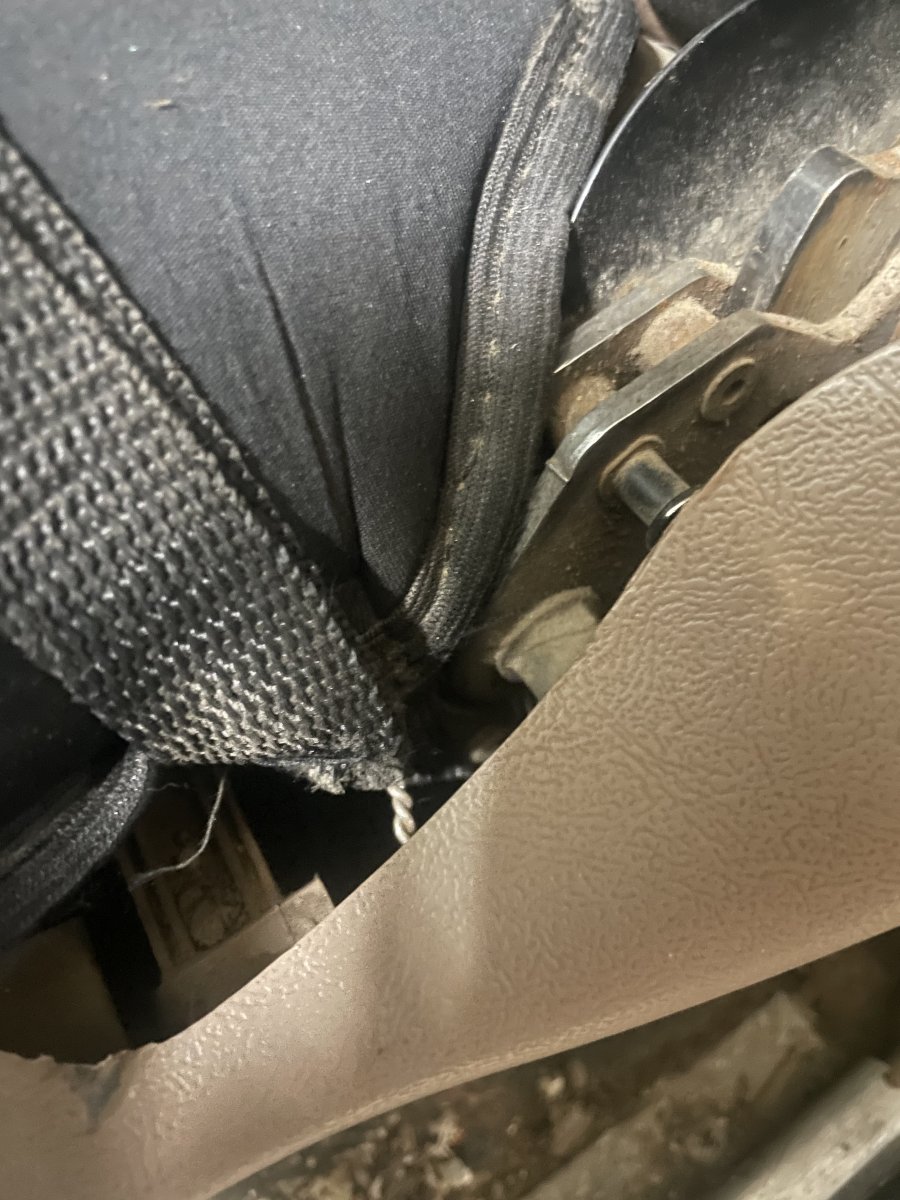

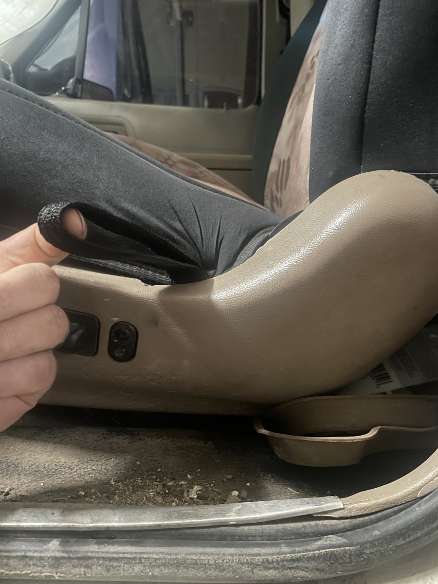

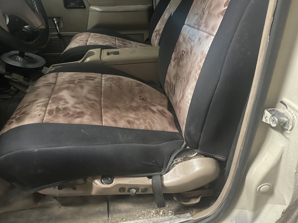

Great idea! But it's a pity we can't see actual pictire how you attached this cloth
It’s pretty simple I sewed the material into a loop with needle and thread (or you maybe able to already find a loop in the fabric maybe even one with a grommet on one end)
And then I poked a hole in it where the heavy stitching is and ran bailing wire through it, a couple of wraps through the first rivet hole
That is all it takes
I was surprised how well it works and there it has been for many years now
