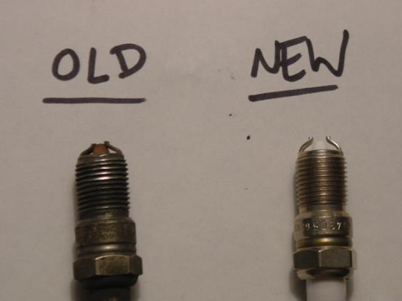

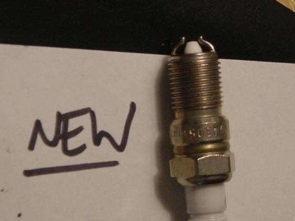

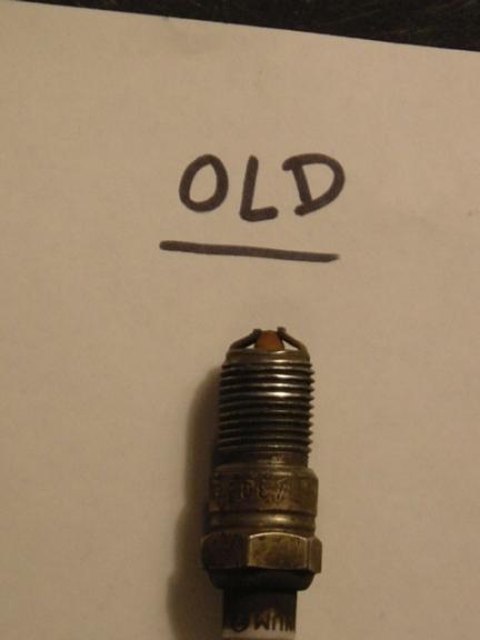

Update: The electrode at the tip of the old plug is very brown, and the 2 prongs of the Bosch Platinum2 by the looks of it have been beaten into the electode insulator, though it's not at all broken. picture to follow....

the threadson the old one looked screwed up
well it got blown outta the motor, so yeah they'd be a little wacky :)

Does the new plug thread into the head or not?

I can guarantee that the plug did not get blown out of the motor. It was probably damaged from dangling by the wire for however long. If it was blown out.. the threads would be bent the other direction. I have a feeling the new plug will easily thread in the hole. :D

so if it was dangling, how would the electrode prong thingies get pushed into the insulator? You probably can't see it, but the prongs have been struck into the insulator somehow, possibly by a valve or something?
The outer electrodes being pushed against the center electrode was caused by a person, or some other physical force outside of the engine.
