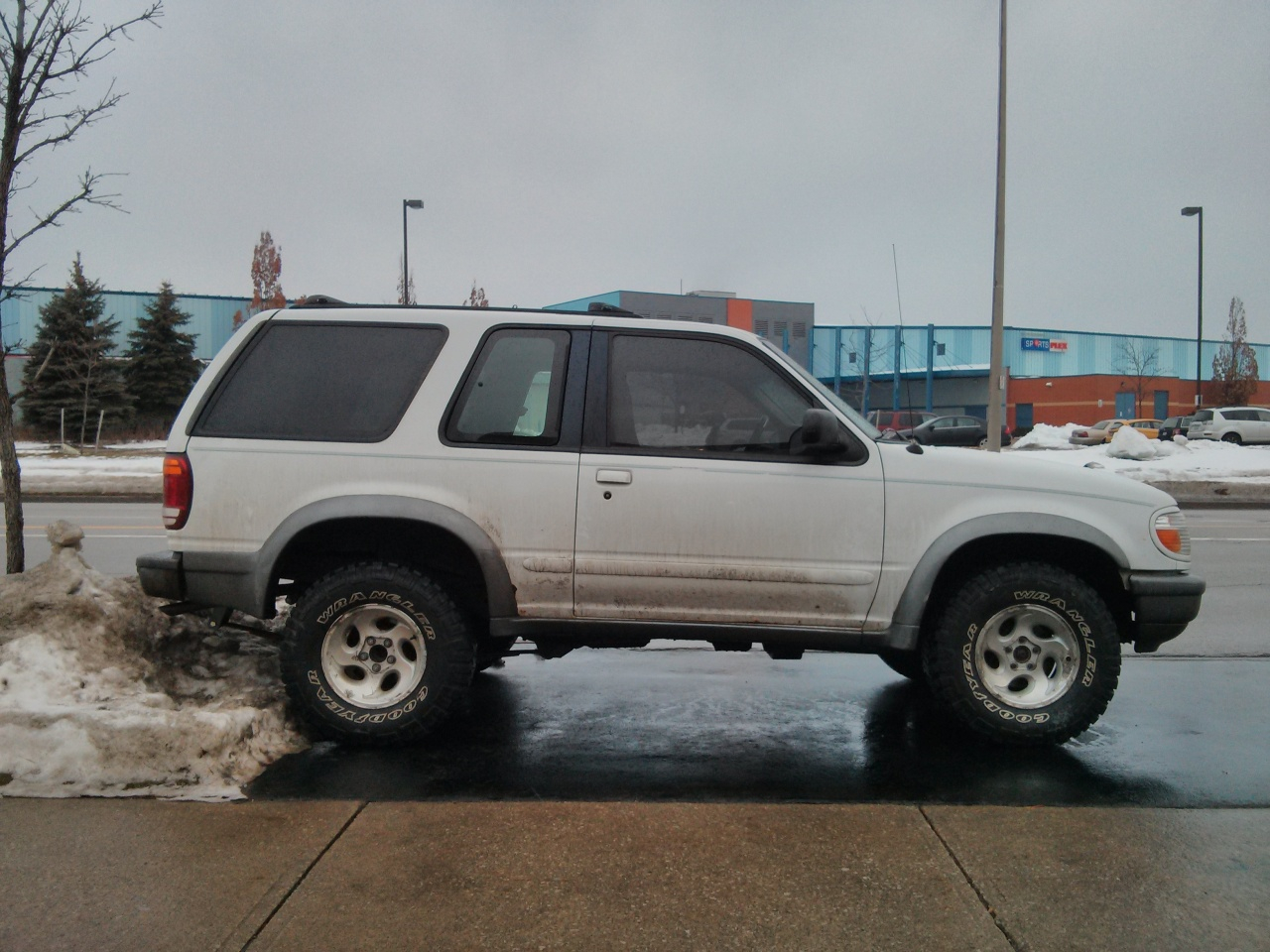

So, with the great help of Sogsnakebite and his buddy Bean, we were able to tackle installing all of the following suspension components:
- Rancho RS5000 for the front
- Monroe SensaTrac for the rear
- XLT leaf pack
- Warrior 153

We achieved a 3" lift on the rear with the SensaTrac + XLT leaf pack + Warrior 153 shackles

In the end, this is what we had...
Front got lifted 1" and rear got lifted 3".
We still have to adjust the TT as we didn't touch them. I think I can raise the front about 1", but my buddy says leave the rake...

Looks awesome. It rides a lot nicer now doesn't it? I'd lift the front up about an inch or so to make it level. I wanted to get 2" up front but I only got an inch because my bolts bottomed out. It worked out though because the shackles flattened by leaf packs out and its sitting level again.
Thanks Vince!
Definitely rides a LOT better than before!
I agree with you, I do want to raise the front an inch, just to level it out some.
