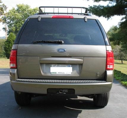

I did leave the V8 badge... couldn't help it...
