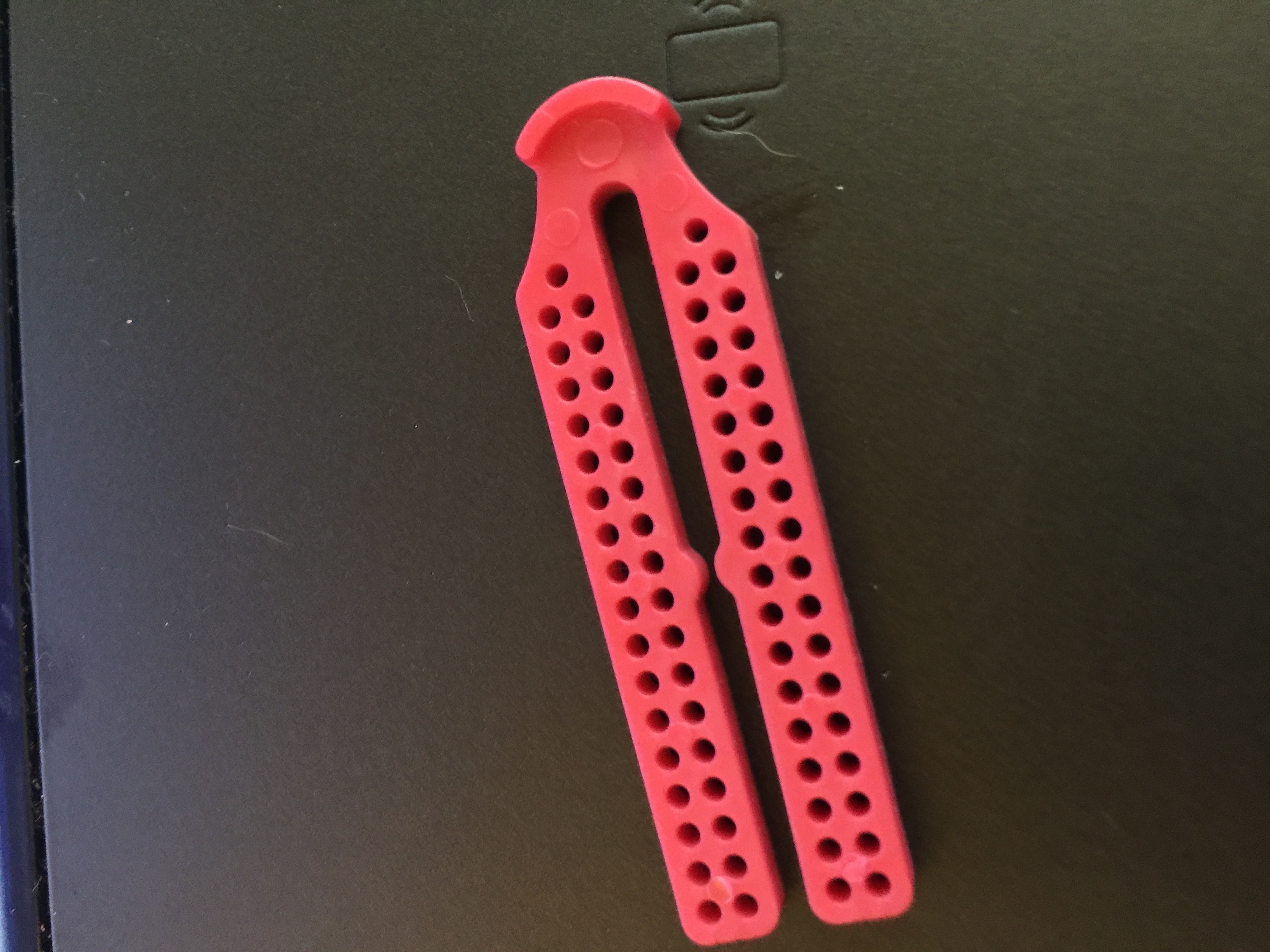

But I do have a glitch / question. I found a 2 inch plastic "clip" lodged under a cable located in the area under the front cup holder. I'm not convinced that I had anything to do with it or if it was the dealer who got into this space a few months ago.... regardless, anyone have any clue as to what this red plastic clip could be used for??
http://www.gday.com/misc/fclip.jpg
-mick
