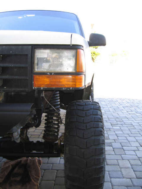

The tires will stick outside the fenders about as much as mine.
he says they are 10.5" wide.
Here's the link to his build thread:
http://www.explorerforum.com/forums/showthread.php?t=171783&highlight=surrealnj
Looks wider from the photos, I like 'em! Ill check out his thread, thanks! ;)
