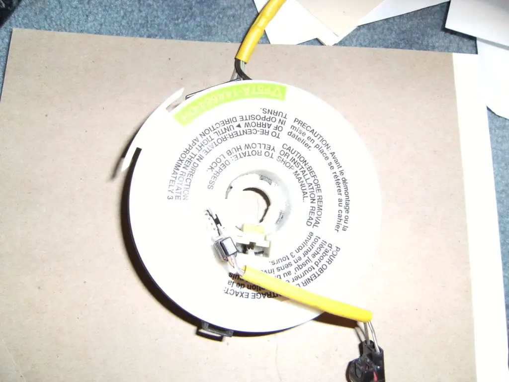

Not sure what happened here, but I went to drive JP home tonight and when I turned the ignition on I got a puff of Smoke from the Air Bag and then a burnt electrical smell. Then the Air bag light started blinking. Now it's just solid. Every time I would make a turn you could a wire sounding like it was binding up inside. I was afraid the thing was gonna blow up in my face on the way home:eek:
I don't really care at this point if the air bags work or not in JP...they are kinda pointless at this point. But I'd like to know what happen here at least....
Thoughts?
Disconnect the battery remove airbag and check the clock spring I bet that's the issue
That yellow wire is the airbag connector...

I think that the airbag going off kills the clock spring...that one up there was dead when I got it out of a crashed truck, the horn wire wasn't working on it
