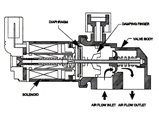

My mind, no smoke should come out of the breather cap.
Very small ammount of air gets in and out of the cap only to compensate
the movement of the diaphragm, so the valve solenoid has no big resistance.

I believe this is the only place smoke should escape.
You can pop that black “knob” off and plug that nipple if you want (for smoke test purposes).
Successful smoke test
Some will escape through the iac breather yes

I'm fairly certain that "knob" on the idle air control vents to the atmosphere, BUT a leaking. IAC diaphragm could be the cause. I do know that the intake manifold gaskets have a tendency to leak coolant into the intake passages.
