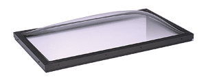

You know I'm thinking that when asked to put a "skylight" on the roof, the build teams first thought was.
"Skylight"
And that is probably what they used. Cut and heated a bit here and there to get the shape not so "skylighty".

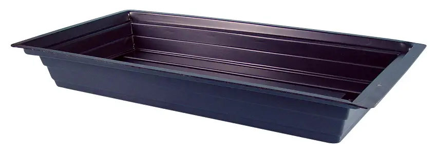

The back portion could be fashioned over one of these green-house planters 48" x 72" x 6" deep. A little spray foam, file, cut, sand and cover with fleece and fiberglass resin just like the speaker box guys do, and wa-la!
I looked at loads of skylights but couldn't find one that was the right size. The production crew had the dome custom made by a shop just south of hollywood. I've actually talked to the people there but they want way too much $ to make the bubble for me.
