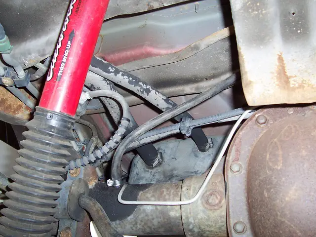

Please post anything you learn about mounting the vent hose if you find something better. I plan to move mine since it's in the path of where a left pipe would go. Night,

I found a length of 5/16 internal diameter hose with some established bends in my hose box. I cut it to length and installed one end on the rear axle vent and locked it in position with a fuel hose clamp.
I created a loop with two plastic cable ties for the other hose end to hang thru.
I used drdoom's trick of partially inserting a trim panel retainer clip in the open end to keep out dirt and moisture.
There are two grooves in the retainer clip sides that allow ventilation as long as the head is not seated against the hose end.
