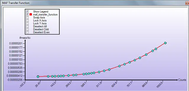

I plotted the std MAF function.
I used excel to create a 4th 5th and 6th order polynomials for that transfer function. The 5th was the best fit.
y = -1E-26x5 + 1E-19x4 + 8E-14x3 + 7E-08x2 + 0.0107x + 52.087
y is Air flow
x is ad counts
Then to establish the new air flow value for the scaled voltage I divided the value in the left of the MAF transfer by 0.91 then used that in the above polynomial to calculate the new air flow value. Then stored taht back into the table. ie more air for each ad count
I used excel to check the new MAF function still had the same characteristic polynomial.
In the working range which is above 200 ad counts the Air Flow increase was between 20 and 33 % more, higher at the higher end of the scale. The above polynomial is not linear.

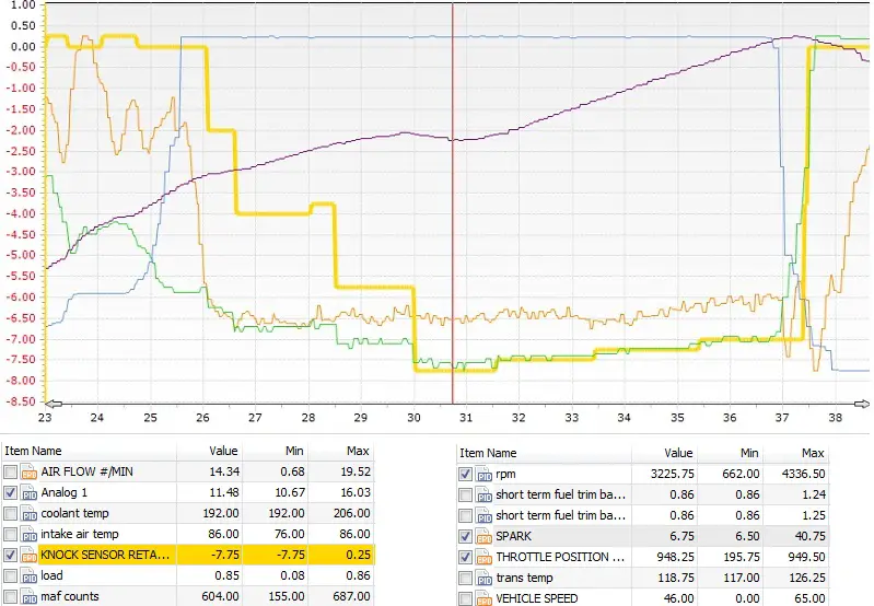

The spark table I showed has got the part throttle now under control.
But in the boost zone it seems to be excessively low.
I can only read a voltage from the knock sensor and do not know how to translate that to a knock event.
I do not see any changes to timing when I here knock.
ie all my part throttle knock sensing has been by ear.
Maybe there is a fault with the knock (statement of the obvious) but from data logs I do not know as I have nothing to compare against.
But my ear has go me to no part throttle knock and do loss of fuel economy.
On boost but off WOT is feels strong WOT seems to be lack lustre ( and why should be good with only 10 degrees of timing)
I am suspicious - I'm missing something

Below is the Advantage III plot of the stock 55 mm MTF.
It appears to be fairly linear near the max. My stock table top entry is 1023.9/5.0044 volts.

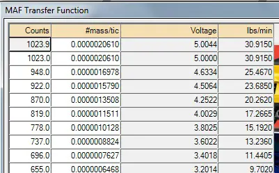

The PCM performs a linear interpolation for MAF AD Counts vs #/min. I decided to compare your max count to my stock MTF max count.
Stock
1023.0 30.9150
Ranger
1023.984 35.808
957.734 29.276
interpolated for 1023.0:
1023.984-957.734=66.25
1023.984-1023.0=.984
35.808-29.276=6.532
(6.532/66.25)*.984=.097
35.808-.097=35.711 for 1023.0
35.711/30.915=1.156
1/1.156=.865
However, for your voltage divider:
47000/(4700+47000)=.909
.909/.865=1.05
So at AD count=1023 your MTF correction is 5% too large
The other error potential is that even if the stock MAF sensor has the capability of outputting a voltage greater than 5 or 6 volts without performing a bench flow test the transfer function is not known. Most bench flow tests are terminated at slightly above 5 volts output. Years ago I attached my stock MAF sensor to my electric leaf blower for some testing. With the blower on high speed (120 mph) the MAF sensor output voltage was 5.25 volts. I suspect the MAF sensor sensitivity decreases rapidly above 5.0 volts. The corresponding voltage output for my LMAF 90 was 3.2 volts. According to SCT's value file for the LMAF 90, 3.2 volts is equivalent to about 19 lbs/min.

If I could find a PID apart from Knock Volts or a Spark PID apart from ( what I assume is) final spark I would be on my way to knowing what was going on.
The spark always seems to be what is in the Border Knock Table.
Thus my desperate need to get on the forum. It seems my processor code and strategy are not extensively developed.

My stock MTF top two entries for lbs/min were also identical.
Advantage III prohibits changing the max AD count value but not its associated lbs/min. I chose the other 29 AD count values to get the best resolution for interpolation - less points on straight segments and more points on curved segments of the LMAF 90 bench flow test results. For MTF the PCM interpolates but does not extrapolate. However, that should not be a problem as long as the read AD value is within the range of the MTF table. Unfortunately, I've found that the PCM does not interpolate for all of the calibration constant tables. In some cases the PCM just uses the table entry just below the value read by the AD converter. Interpolation takes processor time so is not performed on less critical functions.
