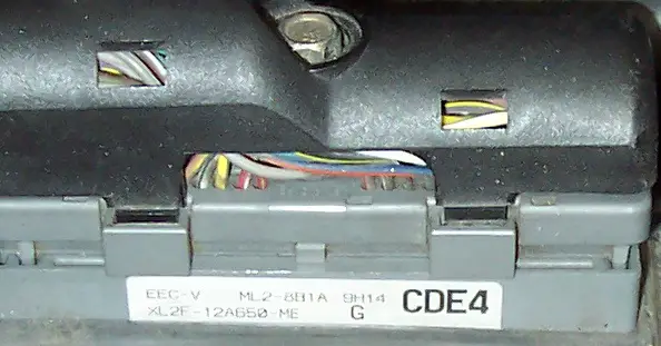

I didn't even have to pull the connector:
CDE4 agrees with the entry in the second table for the first 5 digits of my strategy. Part number is XL2F-12A650-ME. According to ebay listings same part number was used on 1999 thru 2001 Explorers. I found one for $40 plus $10 shipping. Having a back up is probably a wise decision. However, I have to deal with PATS. Is $50 a decent price?
According to OBDTester.com:
XL2F-12A650-ME/CDE4 > YU2F-12A650-AFA/HWG0 > YU2F-12A650-AFB/HWG1 > XU7A-12A650-CAA/????
