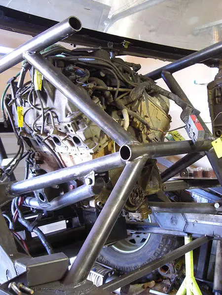

As for today, I removed the automatic:
Manual on the left, Automatic on the right:
Both are the same exact length. I was going to bolt up the Manual to the engine today but I got a phone call and couldnt pass up riding in DC.

Look at the manual tranny
