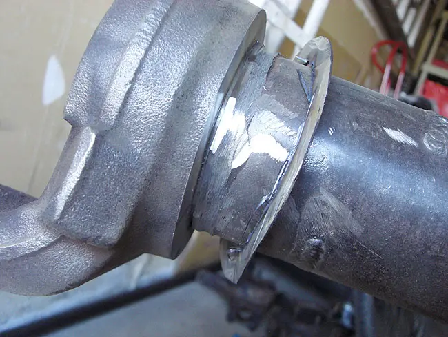

For the past few days I've been trying to tackle the inner knuckles and finally got both of them off.
Started by grinding away the old weld, then slicing a thin ring about 1mm thick:
This is the separation line between the axle tube and the inner knuckle -- its not always this apparent though:
Then came the heating process, then a quick blast of cold water was applied to the tube to try to get it to shrink just a bit:
After a lengthy time of banging on the axle, finally the knuckles came off. The passenger's side was a lot more difficult than the driver's because the knuckle was gouging the tube on its way out, so more friction to overcome. Needless to say, I'm dead tired after swinging that sledge hammer for a few hours
The guilty party
